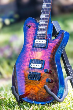

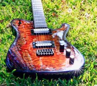

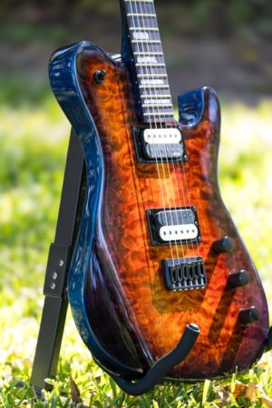

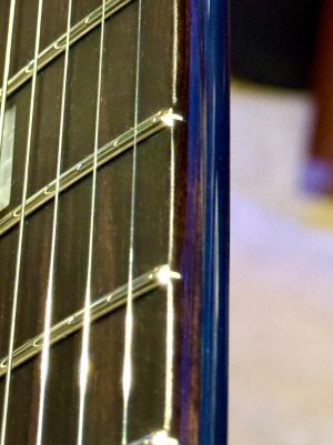

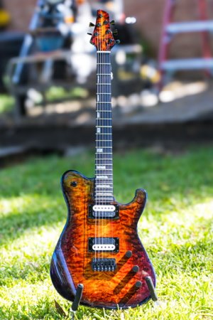

Finished her up today and got it all dialed in, and Man I am in love ! Instant bond with it and I can tell right away it will be one of if not my favorite. Super comfortable to play and the neck is a dream. I spent more time than usual on the fretwork while waiting for the Nitro to cure, and it definitely paid off. I was a little disappointed in the final finish, as it seems some of the purple went away somehow, but it is a brilliant mirror finish. I really like the EMG JR Daemonum set, and was surprised how well they cleaned up also.

EMG Retro Active Jim Root Daemonum Set
Hipshot Grip-Lock Open Gear Tuners
Hipshot Hardtail Bridge
Switchcraft Output Jack and Toggle

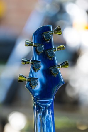

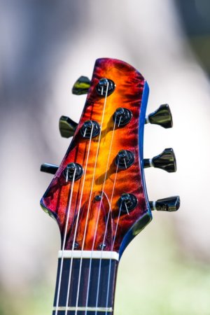

Keda dyes for the front and headstock burst.

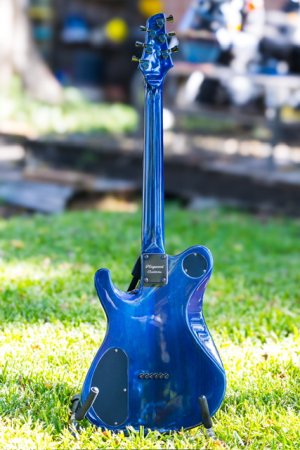

Oxford clear gloss Nitro tinted with Mixol Dye for the back, sides and the neck shaft. No 99 Ocean Blue and a touch of 27 True Red Mixol.
18 coats of Oxford Gloss Nitrocellulose Lacquer over body and neck shaft/headstock.
Sanded with Super Assilex and Buflex to 3000 grit.
Buffed out with Meguiars Scratch X and polished with Meguiars Ultimate Polish and Carnauba Wax.
