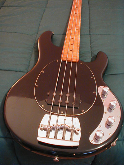

Hi,
I am thinking about building a MusicMan StingRay sound alike. I've played through a modern 2-humbucker stingray, and found the coils 2&3 position (2nd position) to be very nice sounding, so I figure that building one with a single humbucker in the sweet spot will likely sound similar. I'm currently thinking about doing some sort of black korina jbass with either canary, pau ferro, or wenge neck. I'm thinking about using the Nordstrand mm 4.4 pickup and the 2 band eq preamp (2b-3a).
Nordstrand pickups:
http://www.nordstrandpickups.com/bass-pickups/modern/
Preamp:
http://www.nordstrandpickups.com/preamp/
Now for the questions:
1) Does it sound like this will be a pretty close sound to what I've already played through? Ideally it would be sonically equivalent, maybe just a bit punchier.
2) Is the preamp I selected correct? I'm not sure if I'm getting one that assumes I'm getting two pickups.
3) I'm not really sure about schematics for the preamp circuit. Is it safe to assume that I'm just going to be soldering the extra components (input jack, battery,etc.) into the circuit board that I get from nordstrand? It seems either much more complicated than a 2-pickup guitar or much more simple.
4) If I got the 2 band preamp, it would fit just fine in a jbass control plate, correct? Should I rear route?
5) I have no idea for bridge and tuners. Ideas?
6) Any other general thoughts on the build?
Thanks,
Bryce
1) If you go with a korina body and a neck that's not maple, you're already moving pretty far away from your starting point. Some people will argue that canary and pau ferro sound similar or exactly the same as maple. Some people will argue the body wood makes no difference. I would argue that if you're trying to make something sound like a Stingray, you want to construct as similarly to a stingray as possible. I believe that means an ash body and a maple neck. I don't know what your definition of "punchier" is, but i would bet that everybody's idea of what that means is different. If you can give us an idea of what that means in more scientific or objective terms, maybe we can help you move closer to that idea.
2) I don't know if there's a correct preamp to go with. I know a lot of people have said that the signature MM sound comes largely from the preamp. A Nordstrand preamp is going to be top quality, but it may not sound like a MusicMan and it's clear, natural character may be the opposite of what you're going for.
3) I haven't done this, so I can't answer
4) not sure either
5) tons of options for a bridge. I think the vast majority of people building basses on here go with Hipshot Ultralites, because Warmoth bass necks are notoriously heavy and you want to reduce weight at the top as much as possible to avoid neckdive.
6) the awesome thing about a Warmoth is that you can basically get a lot of the design characteristics of your favorite instrument in whatever shape, color, size or form that you want. Obviously the tonal properties of the wood have to hold some weight above the aesthetic value, but it depends on your priorities. If you've got a little extra money to burn, it might not be a bad idea to try something new and different. If you don't like it, resell the parts you're not happy with and try something else. If you don't have the funds for that, I would probably just stick to the tried and true equations of components and focus on making it look and feel like your custom guitar.
The MM tone is mainly a product of the pickup, it's placement and the preamp. AFAIK, the MM preamp is NOT transparent, and therefore, the Nordstrand preamp probably won't get you anywhere near a MM tone.
I'm curious, why not just go with a MM clone preamp?
FWIW, that's a regular single-input preamp, so it doesn't care how many pickups you wire to it's input, so long as the output impedance of the pickup(s) is not too high that it would require an input impedance above 1M Ohms. (Piezo bridges, for example.)
OUTPUT jack! The signal flows OUT of the bass.  All you will be doing is wiring one pickup to a volume pot, into the preamp, and then to the jack. If Nordstrand does not have a diagram for this, I'll draw you one.
I'm reasonably certain that you need to rear route. The only preamps that fit in standard top-routed Jazz control cavities are the control plate-mounted Audere and J Retro preamps.

On second thought, perhaps an ash body probably would be better. I am pretty committed to getting a raw neck, so maybe canary would be my best bet. Thanks for the recommendation on the tuners.
I realized that I misspoke and that the pickup I was thinking about was the 4.2. This one appears to be more faithful SR.
So it sounds like the biggest point of contention would be the preamp. I originally thought that the preamp I mentioned was meant to be a SR clone. I'm sort of privy to the DIY option from ebay.  Is the SGD Lutherie a legit source?
Any thoughts on pickup placement (single in sweet spot vs two pickups?)
