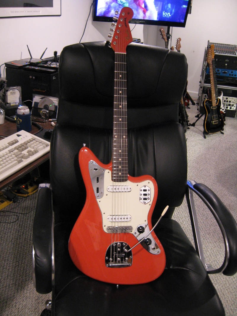

As far as I know, he never did post any pictures of his Jag, so here's one...
Design by Leo Fender, a lovely Tonar finish, and my tender ministrations.
Yeah. He went all out... Warmoth body and neck, nitro finish by Tonar, Lollar pickups, Mastery bridge, neck work/wiring/assembly/setup by me. As Jags go, a tough one to beat. One of the more challenging builds I've done. Lotta problems. Could've invented a lotta new cuss words if I weren't such a potty mouth already.
