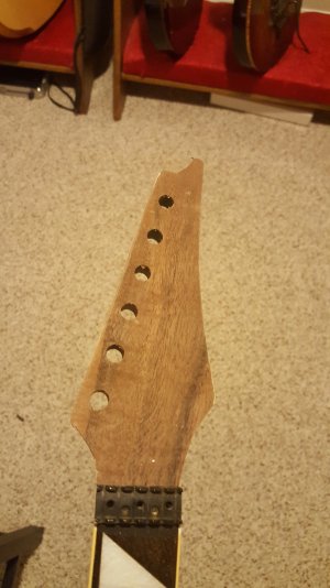

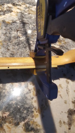

The second photo is the neck repair.  It has a separation at the scarf joint.  I was able to repair the joint and a super high 2nd fret.  You can see the binding is actually cracked where the neck separated.

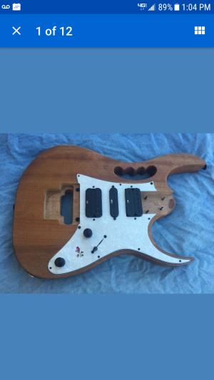

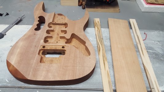

The 3th photo is of the donor JEM body.  I will use this as the core for the build and also utilize the Ibanez pickups.  This was the only part we had to purchase.  It will also serve as the Mahogany part of the build.
I had some walnut Veneer from another build so I decided to add this to the headstock.  This is before sanding and finishing.

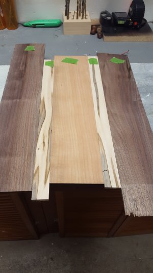

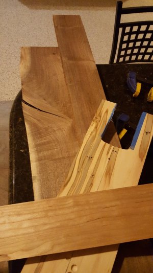

Some here is a shot of the wood.  Ambrosia maple, cherry and Walnut.  I will cut approx 1/4 inch lam tops for the mahogany body.

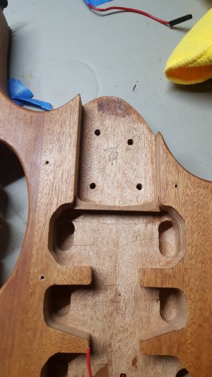

I also made some additional adjustments to the body.  Interestingly enough these bodies do not have a bottom edge to the neck pocket.  The pocket runs right into the pickup route.  I used some mahogany and shaped a piece to come close to the contour of the neck heel and also allow me to easily install the neck for a 25.5 inch scale.  Since I am miss-matching the body and neck the holes don't exactly line up so I have to fill and drill new ones in the neck.  I will also have to adjust the neck pick up because the body did not allow for a fretboard overhang the Ibanez neck has.  We will probably be eliminating the middle pick up so it is a non issue.
This will all be covered by the lam top.

After a few hours of cutting and planing, the JEM is ready for gluing (I also worked in the PRS mentioned in another thread).
I took some material off the body top with the planer.  I then cut in the wood to the right dimensions and thickness.  It is just about a 1/4 inch, maybe a little less.
The body back is obviously mahogany.  The center strip is cherry.  This was the most unremarkable piece of wood so I used it for the center since so much will be cut away.  The next thin strip is ambrosia maple with the walnut filling up the rest of the top.

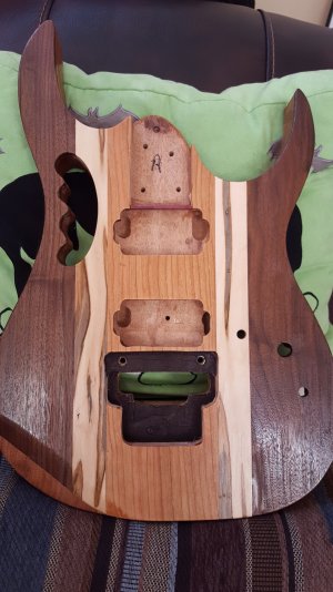

Looking killer.  Whammy and Monkey grip cut.  I had to freehand much of the whammy.  There was not enough room for the router bit guide because the wood remaining was too small.  I will finish it off by hand.
  I did not use the router for the upper horn.  I will use my sander to get the final shape.  I then have to work on the forearm contour.  This will be a first.

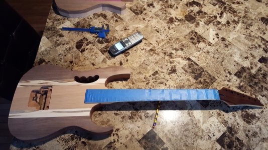

I just added a skim coat of shellac.  It will be sanded and then cleared.  I see I repositioned the pickups a bit.  I am using a mismatched neck and body and hard to set the neck slightly deeper into the body.
I am real happy with the progress so far.  The forearm contour turned out great.  My 1st.
