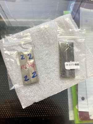

For a while I found the tone to be a just little bit warmer and mushier than I'd like, and knew that the pickups had A2 magnets which tend to be more mushy in the bass, so I recently bought some A4 and A5 mags to play around with. I put the A4 set in last night and I'm liking the change; a tad tighter in the bass, a tad brighter, and a tad more output. I'll have to play it for a while before making a decision, but I think the A4s are going to stay!

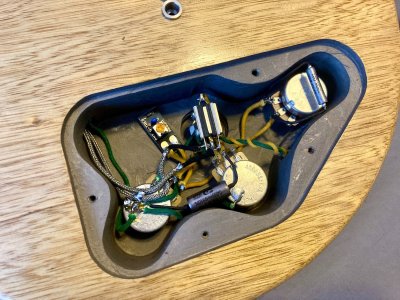

Also, the bass cut pot had gotten scratchy, so I replaced it with one of the new Alpha C1M pots that I bought from Guitar Madness on Ebay. Quick and easy swap!

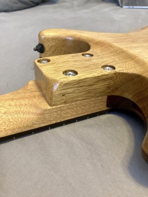

Also also, another that very slightly bugs me about this build is the neck heel; I should have "contoured" it down a little more! It's not terrible, it's just kind of chunky and blocky. Perhaps at some point I'll shave it down a little more, but I'd have to refinish that area which wouldn't be fun. Idk, I should probably just leave it alone, but you never know!

Super Clean control cavity as always from you !

Thanks!
I posted a thread about the pots a while back: basically C1M (1meg reverse audio taper) pots are ideal for bass cut wiring, and difficult to source. I had been buying some from the G&L webstore that were expensive, not great quality, and sometimes out of stock, but I recently found Guitar Madness on ebay selling these Alpha C1M pots in three different shaft lengths.
