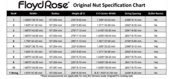

I’ve noticed other guitar makers like LTD will have a 1.650” Floyd, so that got me interested. An R2 and an R3 are the same string spacing, right? So an R2 on a 1.650” wouldn’t be that weird other than the slight gap on the two edges of the shelf where the nut stops.
aarontunes
Administrator
Staff member
2,586
That’s a nice desk/stand setup!
Yes, R2 and R3 are the same spacing, but different nut widths. So you would put an R2 on a 1.650" nut, and there would be, like, .5mm (or less) extra shelf on either side.
I've got an ESP with a 1.650" nut width and a Floyd nut, and the gap is inconsequential. The only complication would be constantly explaining it to customers and trying assuage the ones who's undies become twisted when it doesn't fit perfectly down to the gnat's eyelash. I think that is what keeps Warmoth from offering it as a standard option.
Incidentally, the nut on my ESP is also attached with wood screws from the top rather than bolted from below. It breaks all of Warmoth's "rules". LOL.
bruzanhd
Senior member
180
I think R3 actually has wider spacing.
