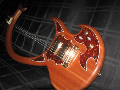

WTF .... :laughing3:Shadowhand said:
Ddbltrbl said:Or, even simpler, you could just wire the 1 tone pot to the left lug of the volume pot and remove everything hooked to the right side lugs of the pickup selector like this:
With this setup the tone control is in the circuit no matter the pickup selection. I believe this is what Jumble Jumble was going for.
Well since the neck isn't on yet, so by just holding another guitar over the top of pup's.Ddbltrbl said:Does it sound as good as you hoped? :dontknow:
Updown said:Well since the neck isn't on yet, so by just holding another guitar over the top of pup's.
For a test run of switching / vol / tone etc ......
Yep know that .... :icon_thumright:Jumble Jumble said:I just touch a screwdriver to the pickup. Can test which coils are active, and volume and tone controls.
Have the amp turned down pretty quiet though!
Get outta my mind will ya :icon_jokercolor: ... had that very thought just after posting, turned around to see a roll of black masking tape :icon_thumright:AutoBat said:you could try some black felt or maybe just black paper under it first to see before you bust out the paint.
Yep sure is :icon_thumright:Bagman67 said:is that a Duncan Quarter Pound in the bridge?
