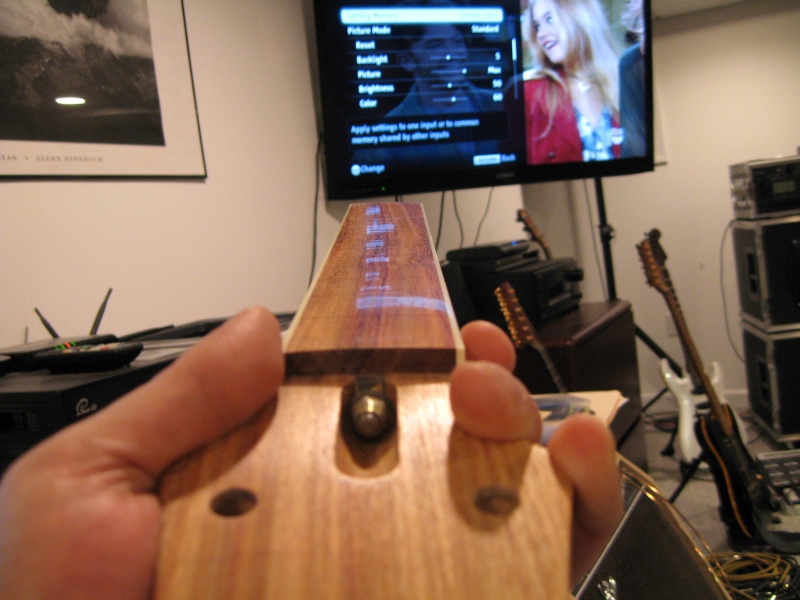

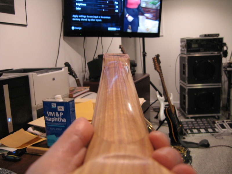

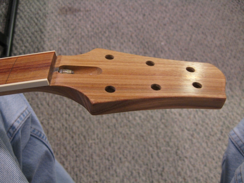

Here's another example of what this burnishing does. This is a Canary on Canary neck...
I broke the corners on the headstock with some 220 grit, then everything got treated to a progression of 400, 800, 1200, 1500 and 2000 grits. Thing is slicker'n snot, and there's no finish. Plus, it doesn't mar like satin finishes do.
It's just an example of "depth of field" focusing. Or, magic. Notice how the writing on the neck is clearer than the TV that is the source  :icon_biggrin:
Yeah, that's depth of field. Your camera is in-focus on the neck, the background images are all blurry.
Looks killer though. Are you sanding dry with those abrasives, or sanding wet using the naptha we see in the pic?
Thanks. I'm sanding dry. The naptha is for cleaning. And the occasional cocktail  :icon_biggrin:
