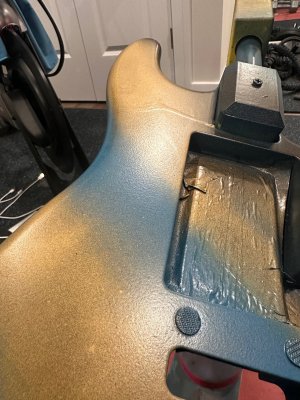

Curious for the community's thoughts on best next step to smooth out a water-based clear coat finish.
Below is an image of an S-style body that I am almost done painting and sealing. I involved my younger kids in the project, so went with Liquitex water-based spray acrylics, which overall worked well. For the clear coat, I used Minwax water-based polycrylic via spray can, in the satin finish. Note the textured/orange peel look after my 2nd round of several light coats. I've read about wet sanding with finer and finer grit sandpaper then buffing to achieve a smooth finish, but wet sanding I have a feeling will not work great with this water-based polycrylic. After the first set of coats I dry-sanded it starting with about ~600 grit paper and then went progressively higher from there (up to about 2000 grit) but the scratches were still very evident, clearing up after i put on many more coats.
I scoured youtube and these forums but couldn't find a tutorial matching exactly what I am doing. For those with more experience in water-based clear coats: how would you smooth out this surface after the final coat, retaining clarity and avoiding visible scratches?
Any advice is much appreciated!!
