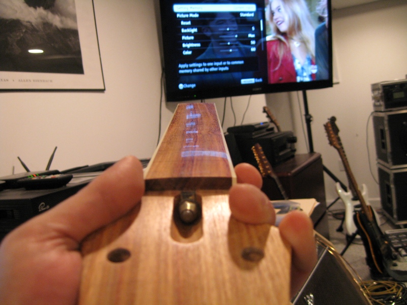

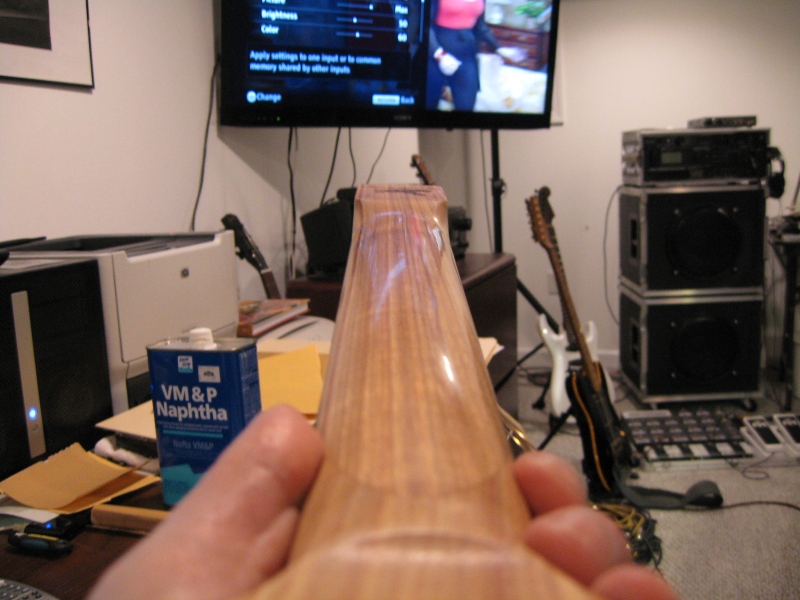

I can't say about the Bocote, but the canary neck I put on the L5S got that treatment and came out excellent. Smooth as silk, and no finish to wear/chip/scratch/discolor. Here are some shots where you can see the original, then the reflection after it's been polished...

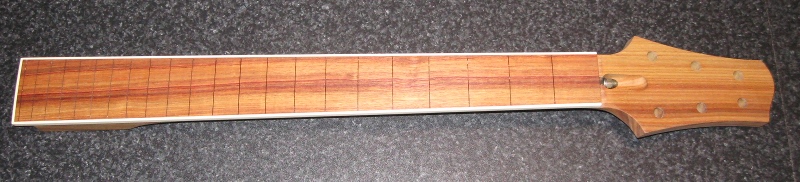

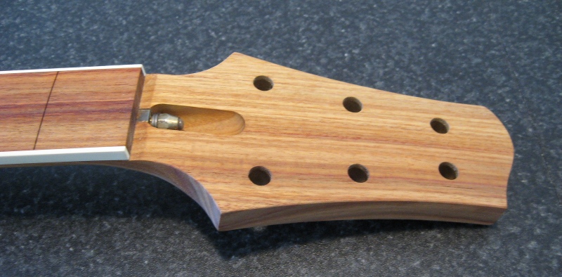

Just reporting in after finishing the polish job on my new wenge neck. As per the pics, it works just fine on wenge.  I've got it mirror smooth. I kind of mixed up all the recommendations on the thread to get to the end result.
I used the 3M polishing paper that Cagey recommended and threw in a 2400 micro-mesh pad in there as well (equivalent to 900 grit - 12 microns) as the polishing paper skips straight from 600 to 1200 and I thought it might be good to have something in between the two. I also used a soft foam pad behind the paper at times when I really wanted to power in length wise and make sure I got over the heel and headstock joints without hindrance.
Couple of things worth noting:  I really like the 3M polishing pads though it's a shame they're missing a 900/1000 grit.  You can work those dry.  Though there are some conversion charts out there, I find that they are not all that accurate.  Even when you go by the micron measurements, the polishing paper just doesn't "cut" as much as it's equivalent "regular" sandpaper.  For example, I bought some 3M 2000 grit wetordry paper which I thought I would use to finish the neck off.  Turns out, that cut in way more than the 1200 3M rated polishing paper (i.e. light blue 9 micron / 1200 grit).  I had to forget about that, go back to the 1200 to recover the finish.  After that I figured I'd just go to the pink 3 micron (4000 grit) paper for a while (i.e. 30 minutes) and that worked out just fine.
Here's the low down on my approach:
3M Polishing Paper - Green (400 / 30 microns): 30 minutes - dry
3M Polishing Paper - Gray (600 / 15 microns): 30 minutes - dry
Micro-Mesh 2400 (900 / 12 microns): 30 minutes - wet (this paper cuts more than the 3M and loads up really fast so dry sanding is not an option)
3M Polishing Paper - Light Blue (1200 /9 microns): 30 minutes - dry
3M 2000 wetordry paper - 5 minutes - wet - I think this was not necessarily worthwhile, it was in my opinion a step back and equivalent to the 900 micro-mesh from a "cut" standpoint.  It did allow me to catch any final "rough grain spots" that subsisted so maybe it was of some use.
3M Polishing Paper - Light Blue (1200 /9 microns): 20 minutes - dry - had to go back to the 1200 to recover from my experiment with the 2000 paper.
3M Polishing Paper - Pink (4000 /3 microns): 30 minutes - everyone says this level is unnecessary and they are probably right if you have a 2000 paper that is less abrasive than the 3M wetordry paper I used...  I found this helped bring out the final shine.  The paper did load up a little bit, not enough to rinse, so it was still catching something.
The results speak for themselves.  By the time I was done with the 900 I was already blown away.  Even my wife is impressed.  Can't wait to take on the rosewood neck on my telepaul.
Thanks to everyone who contributed to this thread.
