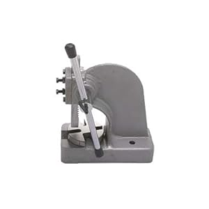

I have a pretty good-sized drill press, but I've never used it to put in bushings (or anything else that requires a press). Seems like it would put undue stress on the drill press that it's not designed to take. So, I always hammer 'em in. Only takes a few hits or so. If you'd rather press them in, arbor presses are surprisingly inexpensive (there's nothing to them) and are good for other things as well. For instance, this 1 ton unit...
...is only $47 through Amazon. It's got an 8" throat depth and a 4.5" range, which is more than you need for most guitars. Of course, the little rascals are heavy as hell, so shipping is killer. But, it's a one-time buy. You can't break them.

This half ton unit is available from Harbor Freight for $27.99 as well.  Not sure whether its throat is deep enough to accommodate a guitar body but if so... you're in bidness.
10:1 that's the same unit at a better price. One of them may be mis-marked as to tonnage, but 1/2 ton is certainly more than enough force to press a 7/16" bushing into wooden body.
