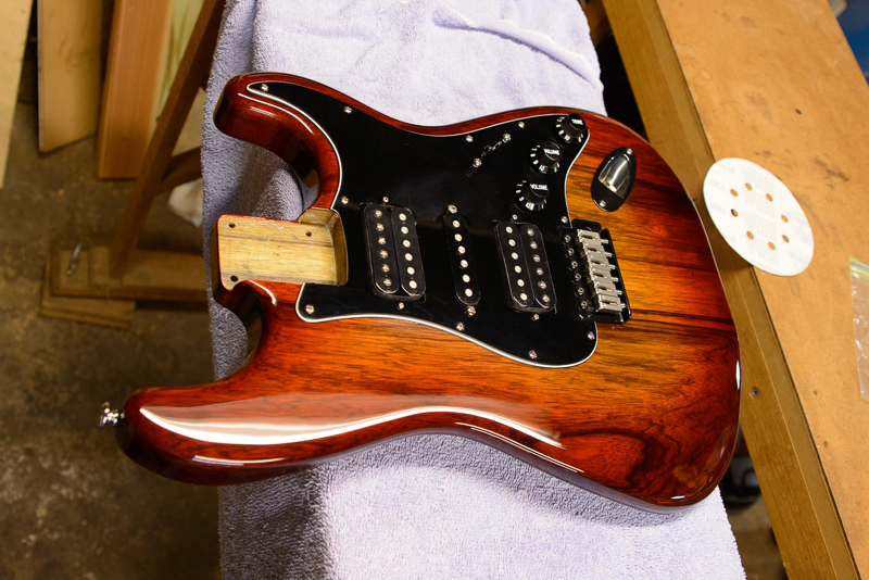

Well, I started hand polishing with the 3M stuff and I'm like "this is gonna take forever"  :sad: So I found a buffing thing in the cabinet, and wire tied 2 cotton sock toe ends to it, to make a fluffy ball thing that I used in the cordless drill. Worked great! Followed up with the swirl remover by hand. Just need to get some wax for it. The dirty scratched pickguard now looks like crap compared to the body.  :tard: :laughing3:
Wow! That looks fantastic! You must be very pleased! Didn't get to do it doggy style, but maybe next time.

Thanks, took most of the day but it was fun!  :icon_biggrin: The pic with a DSLR bugs me... It's NOT that red!!!

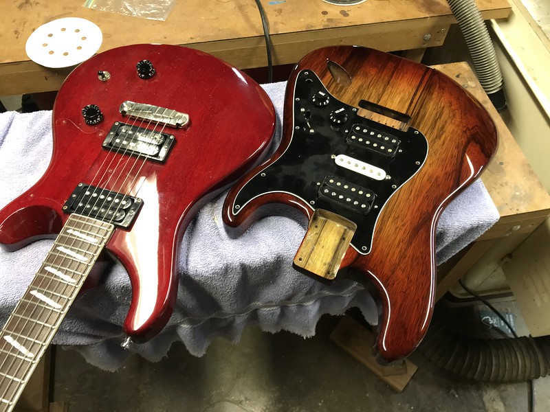

I don't know what's with that camera, my phone takes more accurate pics.  :tard: So I took a pic, with my phone, of the body next to an actual red guitar, a mahogany Santana SE. It's pretty much Gibson's heritage cherry that's on SGs and such. I mixed red and brown for the burst, and that's pretty much what it looks like.

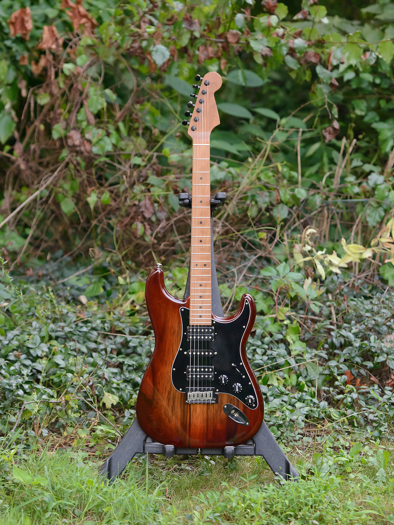

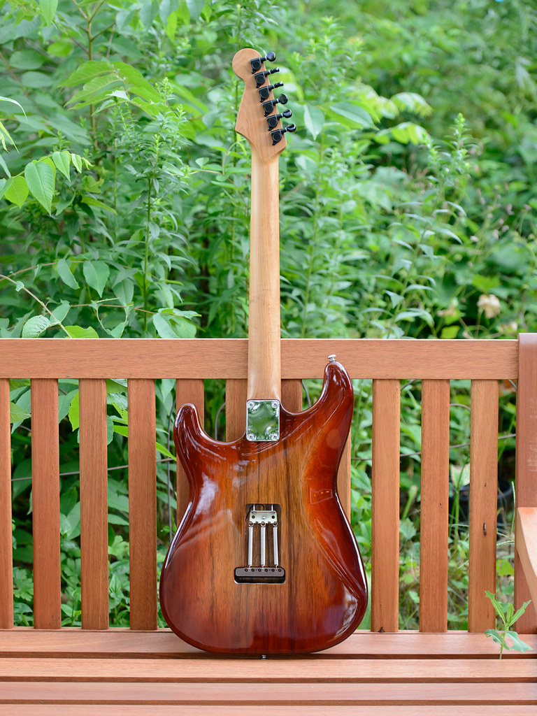

Done!!!!!!!!  :blob7: :hello2: :bananaguitar: :cool01: :turtle: :headbang:
The neck heel is contoured, and the neck sanded back all the way to the heel. The 22nd fret is further away on the conversion necks, and this will make it easier to reach.

Looks very good. You must be pleased.
