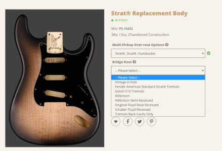

So does anyone knows which tremolo cavity from attached picture should be chosen to fit this Schaller Vintage tremolo (Floyd Rose Style Tremolo) ?!
Perhaps there has been some misunderstanding of what is being asked due to language differences.
The back cavity is of the same dimensions. It is indeed the stud or screw mounting and openings that is the main difference between the tremolo routings rather than the back cavity.
If you ordered the Tremolo Back cavity only and drilled for the studs etc yourself that is an option. Or Floyd with an angled pocket, or Schaller Floyd recessed but with that you would end up with a recess for where the fine tuners would go and you might not want that.
Exactly my point ... there is no option to choose "Floyd with angled pocket" :(
sergejk said:
That option is available with build to order bodies and should be I believe also with unfinished bodies. It may be the option has been missed on the new website or it is now only build to order. If you contact Warmoth sales they should be able to confirm.
