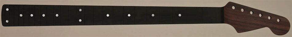

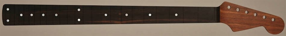

I agree with DesmoDog - had I won, I would have built something I normally wouldn't due to cost. Carved tops are always pricey, and I love Strats, so I probably would have nabbed this body...
Mahogany carcass with a quilted top, binding, nice, Nice, NICE! Put a Wilkinson vibrato on it, some kinda pickups - probably a SD JB & Jazz. Then, so the strings would have somewhere to anchor, I'd have added this neck...
Standard thin ebony over rosewood, with an ebony headstock veneer and pearloid block fret marker inlays. Also nice, Nice, NICE! Only thing I don't like about it is the binding keeps you from putting SS frets on it. But, it's so pretty...
Oh well. Next year.

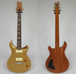

I voted goldtop. If I won, I was thinking about a goldtop LP, cream binding, with cream bound ebony board and no face dots, dual 'buckers (but P90s are a solid choice too).
But since you won, it's your choice...
Thanks for all the input!

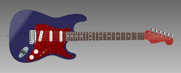

A few pictures to ponder: A strat mock-up, A goldtop McCarty, and a couple Baritone necks that might look nice on a Jazzmaster body.

I priced out the Strat build. There's some left over for a 12-string Tele neck. I'll estimate the goldtop next.
Body:
Swamp Ash
Top Rout
Contour heel
Battery Box
Trans Blue
$420
Neck:
Bloodwood
Kingwood Fingerboard
SRV Contour
21 Frets
SS6115 Frets
MOP Dots
LSR Prep
$427
Hardware from Warmoth:
Pickguard $28
Fender Bridge $90
Knobs $3
Metal Decal $3.75
Battery box $10
Strat Jackplate $5.50
Pickguard screws $2.25
Contoured heel neck screws: $2.60
Schaller Staplocks $13.25
$158.35
Hardware from elsewhere:
Dangerous neckplate $50?
LSR nut $37
Fender Staggered Tuners $43
EMG SAVX pickup set $229
$359
Total: $1364.35
i've gotta say goldtop VIP! this thing has been in the showcase forever. not the exact layout you want, but MAN it looks great.
Tempest said:
Gold VIP or a gold carved tele like Max said..
Goldtop Carved top Tele would be kinda interesting........ Could Max do a mockup and see how it looks? :icon_scratch:
Sorry, not a tele. If it is a goldtop, it looks like a VIP at this point.
Here is a take at pricing the VIP:
Body:
Mahogany/Maple
P90 rout
TOM no STP (assuming $45 upcharge)
Ivoroid Binding
Goldtop/Clear
Solid $895
Chambered $917
Hollow w/double F-hole $950
Neck:
Warmoth Pro Angled
Mahogany/Dk Braz. Rosewood
Straight 12"
Ivoroid binding
Diamond inlay
White TUSQ nut
Clear Gloss
$663
Parts from Warmoth:
Metal Decal $3.75
LP Toggle $12
Ivoroid bonnet knobs $10
$28.35
Nickel Kluson Waffleback tuners $96
Nickel TOM bridge $22
Short Trapeze Tailpiece $35
Nickel jackplate $10
Nickel straplocks (I think I have some)
EMG P60A Ivory $105
EMG P85 Ivory $105
$423
Total: $2009.35 - $2064.35
Looks good to me. Do the chambered, no F hole body. Lose the crummy Kluson tuners, and use something decent like Sperzels/Schallers.
