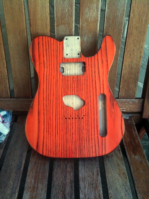

Tonight I fired up the Makita sander and cut the face of the guitar down to size - now we're back to uncolored ash with some ebony filler in the pores.  The back and sides still bear some purple tint, but I'll be doing the back and sides in black so no matter.  I applied a General Finishes orange water-based dye to the top, which contrasts very nicely with the ebony filled pores.  I'll need to de-whisker a little, but the orange is quite rich and dark.  Plan is to lay down a coat of shellac tomorrow and then lightly sand, then do the back and burst edge in black lacquer, then clearcoat it.  I'll put up a photo of the orange top once I can shoot it in daylight - by night in my house lighting, it looks more red than orange.

Photo time (imagine with a flat-black pickguard and rather narrow black burst edge, if you wanna visualize the final product):
The body, by itself:
The body, with neck:

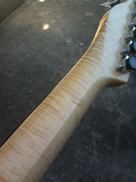

For fun, the tele neck I bought back in early spring, tru-oil'd with about 7 coats:
Before:
After:
Much nicer than the previous finishes. Now, shoot the engineer and get on with production <grin>

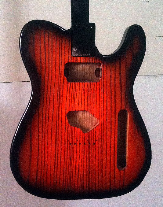

Production has proceeded with all deliberate haste.  Behold:
Atomization out of the rattle can sucked.  Dunno how obvious it is, but the black lacquer particles are quite visible.  But to use Cagey's turn of phrase, guess I'll call this one a love story. Over all, I'm pretty satisfied with the look. I'm probably the only one who'll notice the speckles.

I like the latest finish than the others...clearcoats then you are done?
I like it better, too.  Would have been interesting to have managed one or the other of my false starts through to a finished product, but I'd have to say there was plenty of learning that got done along the way.  And now that it's not raining every weekend in Northern California, I can finally just lay down the clearcoats like clockwork, and finally have the damn thing assembled by end of summer, assuming I have the patience to let the lacquer cure that long.  I'm held up by the pickguard, anyway - gotta order that from W. and I need to make a big enough order that the shipping cost won't be a third of the whole cost.  It's thinking like that that gives rise to new builds...

Very nice! I like this one the best of the lot. The granularity of the paint doesn't show up in the photo, but it's early to worry about it, if at all. Since you're shooting lacquer, there'll be some melting of the finish when you start putting the clear on, which may get rid of what you're seeing up close and personal. Plus, you're going to be sanding and buffing it, so it's not like it's going to feel pebbly.
