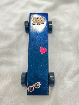

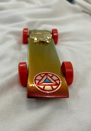

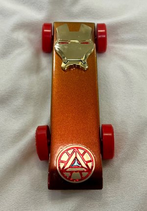

Ok, here they are. The Kustom Canz has a much more intense shift than the Rustoleum. The images of the Chromacoat red are pretty much out of camera, I had to brighten the Rustoleum. In thr sun the Rustoleum is more apparent.
Also, you can see how this type of paint highlights absolutely any surface imperfections. It falls into any low spots and the metallic particles make them jump out. The purple/blue one was sanded and primed, then black, effect, rustoleum clear. The red one was sanded, sanding sealer, primed, sanded, base, effect, clear.
