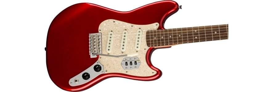

It was interesting to see the Squire release the "Paranormal Cyclone" recently.
I like the style, and I like the 24.75" scale length.
What I didn't like is the slide switches and lack of SS frets although its a Squire obviously..
