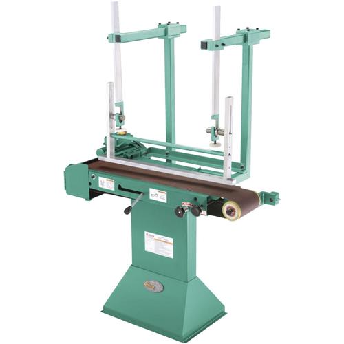

What you're asking for is not something that I think many would use much, if at all. Plus, not everyything is done on a CNC do I'm not sure what you want even exists in the form you want it. For instance, the compound radius is done on a machine that looks something like this...
I'm sure Warmoth has their own design, but that unit is available from Grizzly. They're only a little over a grand, so it's approachable if you want a well-heeled guitar shop  :icon_biggrin:
