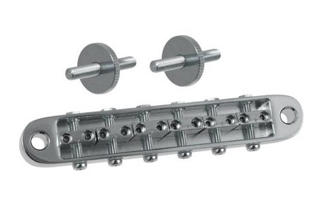

I don't care for TOM bridges due to their design and comfort. They have too many sharp edges, and the saddles only have one axis of adjustment - no individual height adjustments. Then, they sit pretty tall so they require recessing to fix that.
When I think "hardtails", I often think of  Hipshot's offering...
Read the description at the link - there's a lot to love about them. Machined brass base material, stainless saddles, softened edges, machined rather than cast, etc. Very comfy.
I wouldn't buy it from them, though. Shop around. It's clear Hipshot isn't interested in direct sales.

That looks functionally similar to the unknown possibly ESP bridge on my Zion.
I think I've sorta accepted that slab bodies and tight radius necks need adjustable bridges.

Yup. They're surprisingly expensive for being made in Taiwan, but in their defense I must say they're high quality parts of great design that perform well. I've used a few and have always been favorably impressed. The only thing I don't care for is the ostentatious trademark they apply...
I understand being proud of a product, and they deserve to be, but there's a limit. If it weren't laser-etched on the part, I'd wager most people would remove it as it's quite tacky. It's like putting a bumper sticker on a Mercedes  :laughing7:

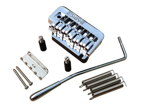

If you're set on a TOM there are options out there with height adjustable saddles, that would make it possible to set it up with a 7,25" radius neck:

From watching the Babicz TOM bridge installation video, it is supplied with a spacer to it sits flush with the body of the guitar, ie. Full contact.
Their website does not show full dimensions, but it looks like it probably wouldn't fit Warmoth's recessed TOM routing.  Interesting product though.

those babicz bridges always look like a 57 chevy boinked a zippo and birthed a guitar bridge. kinda overdesigned, imoo (in my own opinion). if you want a TOM with a small radius, bust out those spicy saddle files. most TOMs are made of really cheap metal, tbph (to be perfrectly honest) so it shouldn't be too hard. desperate times call for desperate housewives, dawg
