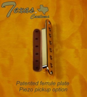

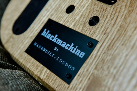

I know it seems like it's ruined but you have some options. The mounting screw hole can be plugged and redrilled in the proper locations. Then a larger bushing or ferrule can be used to make the head of the screw bigger. Maybe Doug could whip something up. You could also have those screws shortened a bit and recessed even more then cover them with a plate similar to what Blackmachine install. For the string retainer ferrule block Texas Customs to the rescue. Schaller should use this design anyway. Good luck brother. I'm truly sorry.

Maybe another oblong plate could be fabbed up the same perimeter as the ferrule block and the mounting screws could go through that. Sort of like a mini Tele control plate.

A variation on Pabloman's suggestion would be fairly clean - just have a square or rectangular plate made of pickguard material to essentially cover the mounting screws and string retainer plate, with holes drilled in that to let you string it up. That would also allow the bridge to moved slightly to compensate for the mis-alignment.
The pickup doesn't need to be moved at all except for aesthetic reasons. But, if that was desirable, the existing mounting holes can be easily plugged and re-drilled to move that, and you'd never see it. The strings still won't line up perfectly above each pole piece, but the error will be symmetrical.
I wouldn't expect those repairs to cost a great deal of money, but you would end up with a plate on the back you weren't planning on. That's not unusual, though. Consider how many guitars out there have much larger plates to cover up vibrato springs, batteries, electronics, etc.
