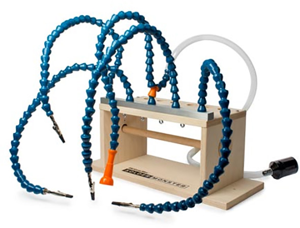

I have some of those. Rarely use them. They often require a 3rd hand, and I was only born with two.
You need the Acme Octopus Luthier Helper. 1,999 USD at Stu Hacks. I find they work a little better than the suction cups.
I recently got the ad for that ill-conceived item from StewMac. Been a long time since I've seen such a Rube Goldberg device. Looks like something you'd sell on late-night infomercials to brain-damaged insomniacs...
Whoever green-lighted that project had to have been snot-slingin' drunk, and whoever set the sell price had to have been on some kind of hallucinogenics.
