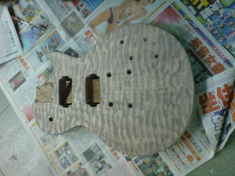

Hi guys, I made a post before on how to refinish my warmoth LP, got some tips. But then I took the long road...... I stripped it down  :icon_jokercolor:  Oooh well, took me around 5 hours, thanks for my friend Mr Power Sander, and now it's ready for anything. (There's some redish dye on the top, but I want to stop here unless it's necessary to sand them away)
Haven't made up my mind yet, but I'm considering something like this:
or perhaps very dark wine red
or something like what Dan has done
http://www.warmoth.com/gallery/galcontainer.cfm?id=437
What would you guys do if this is your top?  I know nothing about the finishing procedures, but I surely will do my homework.

from the picture, you appear to have quite a bit of deep sanding scratches.  What did you sand with, 60 grit?  If so, you are going to have to do some finish sanding with 220 or 320 before its ready to finish, and you might end up pulling the rest of the red out in that process.
For the finish, do a trans blue with multi color pearl
You're right mate, it's still pretty rough after 60 grit sanding, will do a finer touch this weekend  :icon_thumright:

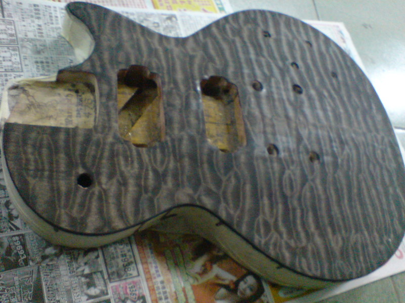

Okay, I nailed it down to that 'Dan finish' and dyed gray black (sorry CB, but that's a great top!)
But I need help on the procedures, and most probably I'll choose the easy one.
Please feel free to give me guides/tips!!!  :headbang:
Well, to me, the top one looks like a stain and maybe an oil finish, or some such.  The bottom is died and most certainly a sprayed clear finish.  If you are not setup to do spraying, you are limited a bit in your options, though I think some here have had good experience with ReRanch's rattle can products.

This is my top, dyed twice, and sanding back, but kinda tired today.  So I'll do the rest this weekend  :redflag:
2nd dye is still air drying
But I don't know what colour is the right thing for that 'almost koa top' brown.....
