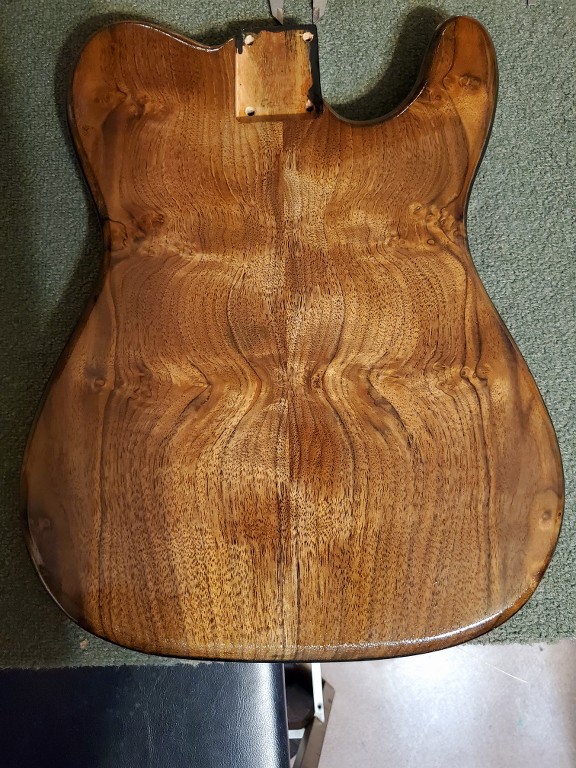

Thanks. I'm liking it so far, it has a nice hologram effect to it. If you tilt it a few degrees one way or the other all the highlights and dark areas swap places.
Sometimes that's really pronounced. Sounds like you got a good piece there.

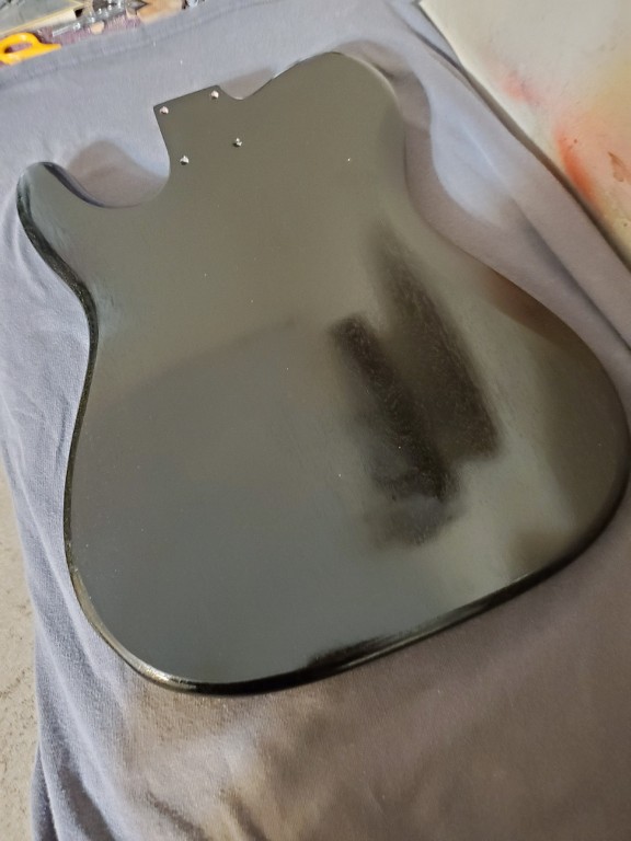

The black on the back together with the angle of the shot and the reflections make the back look like it’s chrome.  :glasses9:
Anyway, that’s an awesome looking body. Your friend is going to be very happy when it’s finished.
Thank you. The back and sides are just black leather dye with 6 or 7 coats of Tru Oil. Hasn't even been wet sanded or polished yet. Still have to put a control cavity and cover.

Ok, this is somewhat how the top looks with 5 light coats of Tru Oil on it.
It's got a nice chatoyantcy to it...
Thanks. It looks even better in person, I'm really happy with the walnut top. Not so happy with Galaxy S10 pictures. Whoever decided that the camera in this thing was acceptable should be slapped about the head and shoulders with the carcass of a foul smelling carp. :o

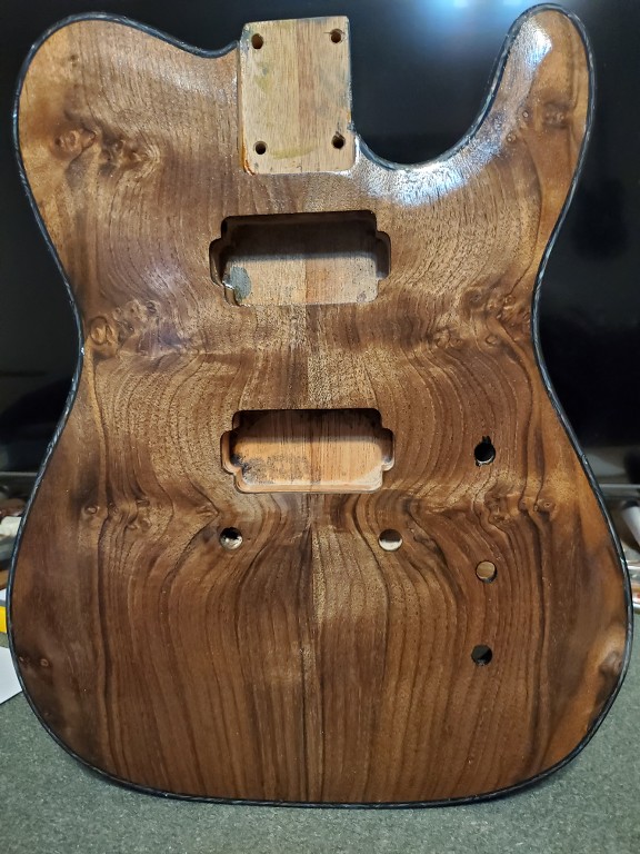

OK, I am making some progress, but it's been difficult. The customer keeps changing his mind. I now remember why I lost touch with him for so long, He's a brilliant man and a great guitar player. However, the words "Pain in the Posterior" come to mind. After many consultations and more than one restart, this is how it stands.

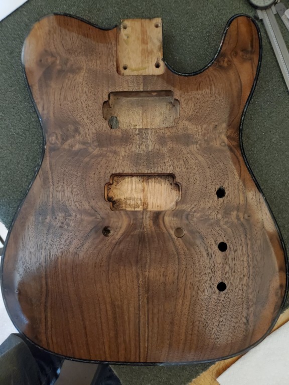

It's been sanded down to just touching the wood and two new coats of Tru Oil applied. The binding is three layers, an inner and outer layer of black pearl, and a center layer of abalone.  Routing for two humbuckers and volume and tone pots and a selector switch. Just simple three way switching for now. Until he changes his mind again... :doh:

Thank You and yes. It's just plastic binding (probably ABS), I used a piloted router bit that put a 1/4 rabbit in the edge and glued the binding in with CA adhesive. With the plastic binding you can get away with sanding it some without it melting.

Thanks. If I can manage to get a nice flat glossy surface on it, the figure in it should really stand out in the end. But walnut is not the most cooperative of woods to finish. Especially pieces that are highly figured or taken from near the root of the tree.
Interesting. That looks like a carved-top body? Must've been a bit of a trick to get the edge routed for the binding. I did the 5-layer binding on the L5S in my sig, which has a flat top, and that was nerve-wracking enough. Build thread's here, if you're interested. I found scraping the binding was more effective than trying to sand it level. Still have to sand it eventually, but the scraper works well to start with.
