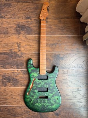

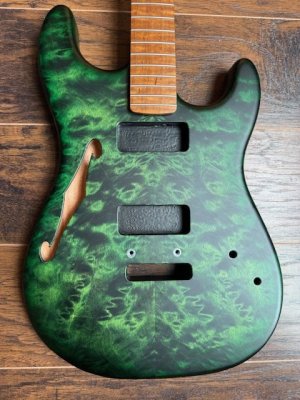

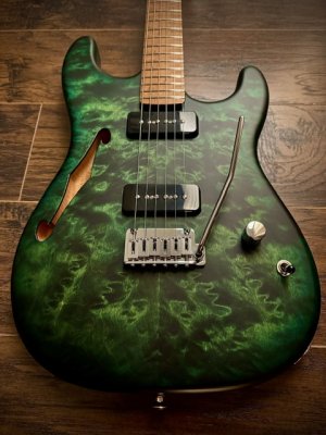

Body: mahogany, quilt maple top w/ green dye and satin finish, burst-over to the back, Fralin p90s on order, single volume control with low profile toggle switch, Gotoh 510. Forearm contour, cut, and contoured heel. Chrome hardware throughout. No tone knob because I haven't meaningfully used a tone knob in over 25 years of playing :)

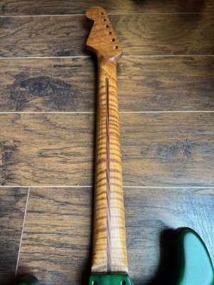

Neck: vintage/modern, roasted flame maple. no fret markers. Modern medium nut, D neck back profile, 9.5-14" compound radius, 22 frets, SS6150. Gotoh tuners. Black side dots, black standard nut. Clear satin nitro finish. Goldo StringThree if it requires it. Looking at Rothko and Frost for a custom logo.
