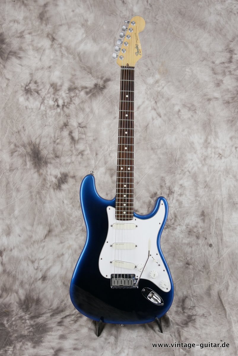

Anyone informed on the issue of tuning machines? Planning to get Schaller M6 for the new neck with inline headstock. I’d read somewhere that if you get them with staggered height posts you can eliminate the need for string trees? Is that accurate?
Yes, Schaller and Sperzel were introduced in the Strat Plus back in the 80s and those guitars never had strings trees, that is also another reason why they remain in tune well.

I use the tremolo a lot and I can say the combo Sperzel(Schaller) + LSR (Wilkinson) nut + American standard bridge keeps a Strat well in tune, not as much as FR but it gets very close. OF course eliminating the string trees, even the low friction one is VERY beneficial.
The Plus series for that era was a very advanced guitar IMO, and it´s a shame it is not well considered today.
Strat plus 1988.
Strat Plus 1993.
