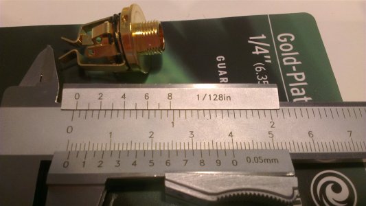

EDIT: Heres some pics and specs for you from the part I received from warmoth. Hope it gets you somewhere.
Measures 0.8mm from top to top center, of each thread. I have no idea how to read inches on this thing..  :doh:
