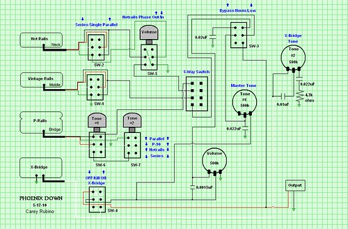

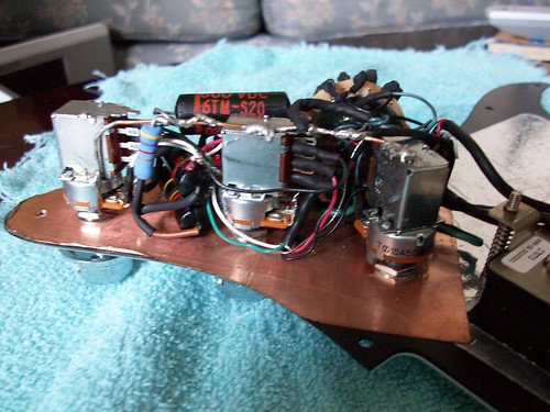

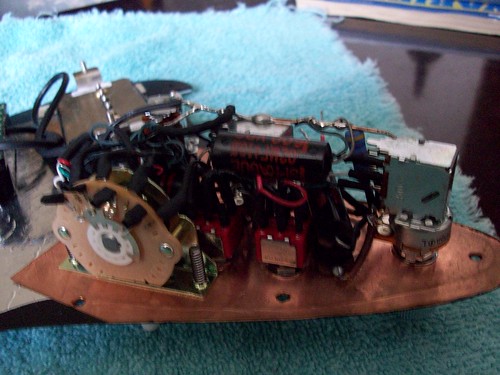

Through the years of trying different pickups and wiring I found two that I liked and wanted to keep were the Duncan Hot rails, and Vintage rails.  I wanted to try the Duncan P-rails in the bridge just to add more versatility to the guitar.  I tried many things and made several mistakes, but put every feature that I like into one final draft circuit.  I made sure the new circuit was more user-friendly and everything was quickly accessible.  I reached the limit of how much crap you can cram into a Strat. One of the great things I like about the guitar is that it consists of all hum buckers, yet it can be set up as all single coils, like a traditional Strat. Now that I have a P-rail in the bridge, that’s basically four different bridge pickups, counting the acoustic bridge. I shouldn’t be at a loss for a unique sound. Unlike a traditional Strat, this one doesn’t follow the normal pickup selection.  I like having the neck combined with the bridge, so I kept it just like the original guitar. Everything else is finished other than the body and neck, so I will follow this with more info

Controls:
Hot rails:  parallel, single coil, series wiring configuration with flip of a switch.
Vintage rails:  same capability as hot rails with switch that matches the 5-way position.
P-rails:  parallel, rails coil, P-90, series, controllable from two push pull tone knobs.
X-Bridge: Operates independently and has a separate tone control that fits its tone quality.
Master Tone:  Has capability for bypass, 0.022uF cap, and 0.042uF value for lower range.
Master Volume: Has high bypass capacitor (treble bleed).
Kill Switch:  The center position between X-Bridge and Pickup selector for use with both.
Phase Switch:  push – pull from volume knob to throw the hot rails out of phase with the other pickups it combines with.

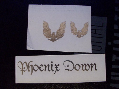

Last, but not least is the headstock decals from best-decals.com.  The best looking bird per size will be selected to go on the ball of the headstock.

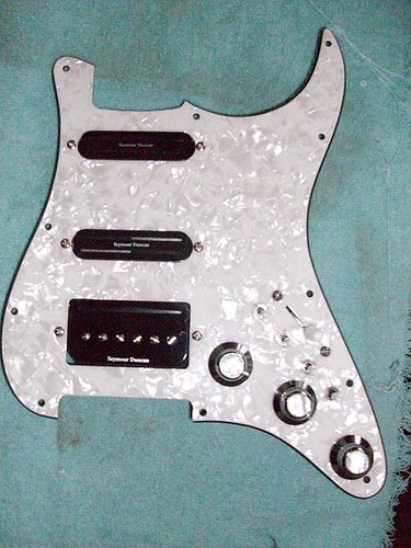

Have you had the P-Rail installed in anything yet? If so, I'd like to hear your thoughts on it, especially how it sounds in the various modes. I'm planning to use it in a future build.
Thanks guys, but I haven't heard the P-rails yet, just staring at the pickguard hoping for the day when I can.  The original bridge pup was a Dime Bucker, which was cool, but not that versatile. That bridge position is really important to me so the P-rails made sense.  This particular one is the newer "hot" version.  That is pretty funny the name did remind me of Final Fantasy, but I meant it as another word for fallen phoenix. :laughing3: and it's haunting me in my sleep.

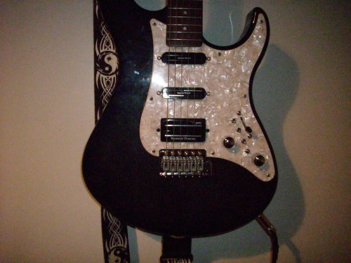

I'm bored as crap over here, and I'm getting the itch to build again... I tried not to think about it to make the time go faster. :sad:  I will keep being patient and won't be contacting Rob for a while, since I know she's not close to being done.  In the meantime I might as well add my first guitar that I'm replacing.  Seemed cool at the time, but is a real POS compared to the new Warmoth body.  That poor guitar was tore up and put back together so many times. :laughing7:
This is the old jack plate I grinded out of a piece of aluminum, which was a replacement for the old plastic one (First custom modification I ever did when I was a youngster).
This is the official heart of the guitar, lonely pickguard awaiting a body...(Update, thanks Rob, she will be on her way to me shortly. :icon_thumright:)
