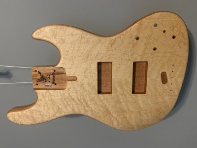

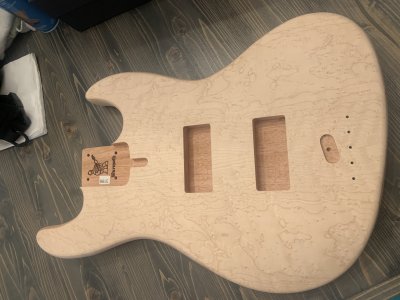

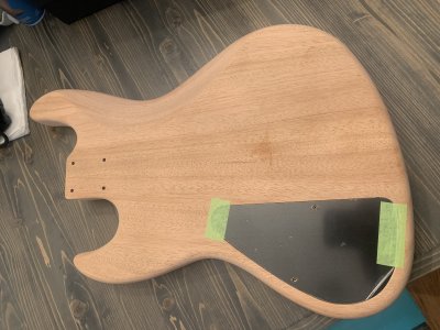

Here is the body, fresh out of the box.

First coat on. Arrived sanded to 220. I took it done with 320-400-600, raising the grain in between each sanded run. Then applied a 50/50 mix of tung oil and mineral spirits using 1000 grit. Tonight I apply a 75/25 mix with 2000 girt. Then tomorrow a final coat of 100%.
This is a standard birdseye top. I was amazed that it also has some quilt to it as well. Has a lot of 3d qualities to it hard to get on camera.

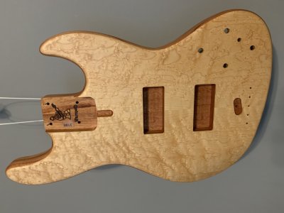

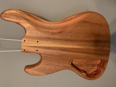

Thank you all for the supporting comments. Just got done doing a final rub down to remove any weeping oil. Now it just needs to cure( a week or two). The body darkened a little bit with the coats of 100% tung oil. I also realized I never posted a picture of the back. SO here is one of the back, and one more of the front after all of the sanding, oiling, and rubbing. I was hoping the neck was going to ship last week. Didn't happen, so I hope this week it will be in the mail.
