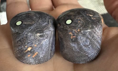

First build and first post! Figured I would document things here. Motivation is (1) being a southpaw I have limited options, and more importantly, (2) I enjoy: putting things together, fine tuning, and tinkering, and (3) learning experience!
I ordered the neck and body a couple weeks ago (so looking at end of May) I am having Warmoth do the routing, most of the neck work, and the finishing of both, to keep things relatively simple for my first go. Here is a summary so far:
Body: Musiclander, alder. Neck and bridge tele pup routes. controls for volume, tone, and blade. Turquoise flake, because sparkly.
Neck: Maple/maple, vintage-modern construction. Moon glow nightswan markers. Stainless steel 6105 frets. 9.5 radius, modern-medium nut width. Gloss finish.
Pickups: Lollar, ‘52 neck, alnico 3 bridge
Bridge: hipshot telecaster with compensated saddle
Tuners: Most likely going with locking hipshot (staggered)
Wiring: push-pull volume with off/on for treble bleed, push-pull tone to switch cap values (.015 µF and .047 µF). 5-way super switch with out-of-phase and series.
As for the name, “Space Cowboy”, feels right, at least for now!
