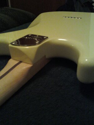

Do I have to get a modern vintage construction to make this possible? Or does a modern construction work? The heel truss rod might be in the way of the screws...
I had the idea about sculpting the neck heel like this before finishing myself and use bushings for screws
Or maybe I can go extreme with the heel sculpting and just have THREE screws?  :icon_biggrin:
That should definitely work with modern construction right?
Yep should work.  I'd use a threaded insert in that neck side screw though - that's where most of the tension is going to be.

Cedrick: to do what you have pictured in the OP you will have to use VintageModern construction. If you try to stagger the neck screws to create a sculpted heel like those pictures using a Modern Construction neck, the screws will run into the Side Adjust Mechanism inside the neck.
More info here: http://www.warmoth.com/Guitar/Necks/faq2.aspx#Incompatible

Yes I have seen that, but the screw doesn't need to be THAT far back
I wanna sculpt the heel more. But I still dont have to put a screw so far back, I can just make sure it doesn't conflict with the side adjustment
(blue lines shows how I wanna rasp it, and the blue line is where the screw can be)
The little adjustment nut visible at the side of the neck is not the entire Side Adjustment Mechanism. There is square box inside the neck that it attaches to. Watch the video below, particularly near the end around the 4:20 mark, to see what's going on inside the neck. I would REALLY recommend not trying to do the staggered screw thing on a Modern construction neck. The three-bolt concept you posted above would have a greater chance of success.

Also I already wrote that it might be too hard for me to actually install bushings properly
Shouldn't 3 screws in the wood be good enough? Since Jackson does it on their recent Dinkys, it shouldn't be too bad... If there DOES become a problem, I could just add another screw somewhere possible

I would not trust 3 screws without threaded inserts.
Just go with the Vintage-Modern neck I'm really happy with mine.
