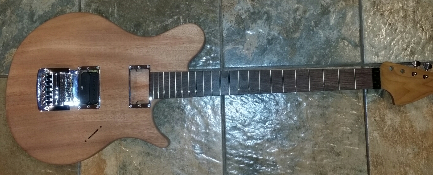

So, my latest project is underway.  It's a Warmoth Velocity (but only sort of).    I've always thought the velocity looked awfully ergonomic, but that upper horn (if you can call it that) always made me go 'meh'.  It just looks... I dunno, unmanly to me.  But other than that little quirk, I've always though 'yeah, like it!'.  So, one day with a copy of photoshop I did some monkeying around, and viola, came up with the idea below.  After me and my current axe won $500 in a talent contest (yes, really), I figured it was a perfect time to give it a shot, and as soon as Warmoth could crank them out, a nice roasted maple neck and mahogany velocity body were on the way to me, and now here we are with a velocity body that will need some body work, and a CBS headstocked roasted maple neck w/ floyd locknut, sans inlays, that I'm going to turn into either a mini 4x2 in the neighborhood of the little mini 3x3 EVH's (except 4x2, obviously), or maybe a more angular shaped 6 on a side sort of in the neighbourhood of some older Carvin's I've seen with a hint of Shur thrown in for good measure.  Dunno, not thinking too hard about that part yet, but the CBS look has got to go; popeye's nose belongs on popeye, not my guitar.  :)
As they arrived (with parts laid out on them to get some idea of what I'm looking at).  Yeah, that upper horn, just lacks manliness somehow to my eyes, must fix, must fix..

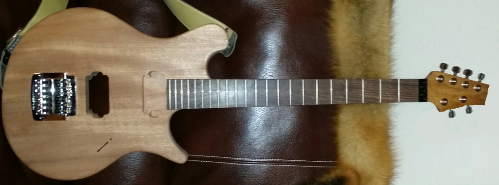

A bit of body work later, and man, isn't this one hell of a lot more masculine?  My eyes think so, and mine are the only ones that matter, so we are definitely on the right track!

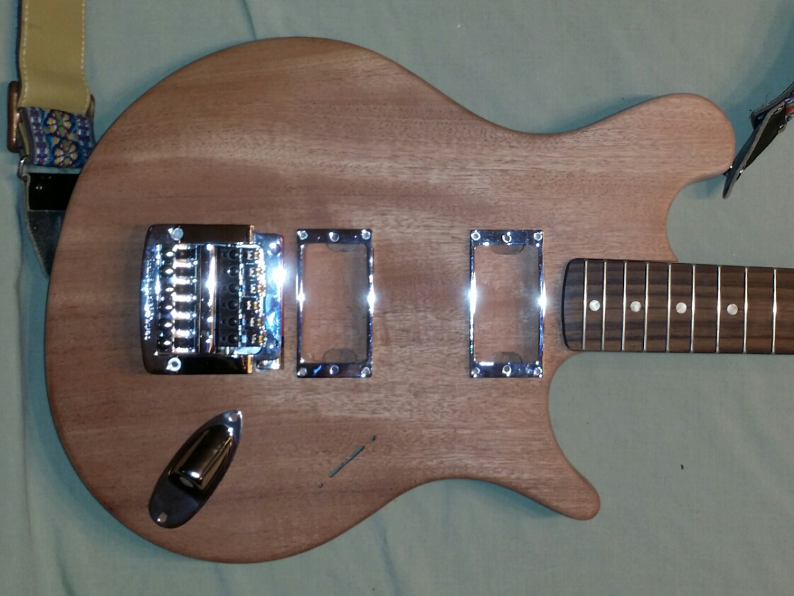

As she sits after tonights work, the Kahler routed, drilled, and bolted down (was surprisingly hard to get lined up perfect - I am technically off by maybe 1 mm to the south of the neck centerline, but Kahler's have left/right adjustment, and I am within the range of adjustable motion, so it's all good.    If I wasn't a dumbass and had actually read the Warmoth pages more carefully, Warmoth would have routed it for me in the 1st place, but I wasn't that smart, so I paid for it by having to rout my own.
Also, while I was at it, I punched the rear pickup hole all the way through.  I change pickups a lot, and I thought it would be nice to be able to swap at least the rear pickup without having to loosen the strings (and the neck pickup isn't that hard to get out with only a slght loosening of strings anyway).

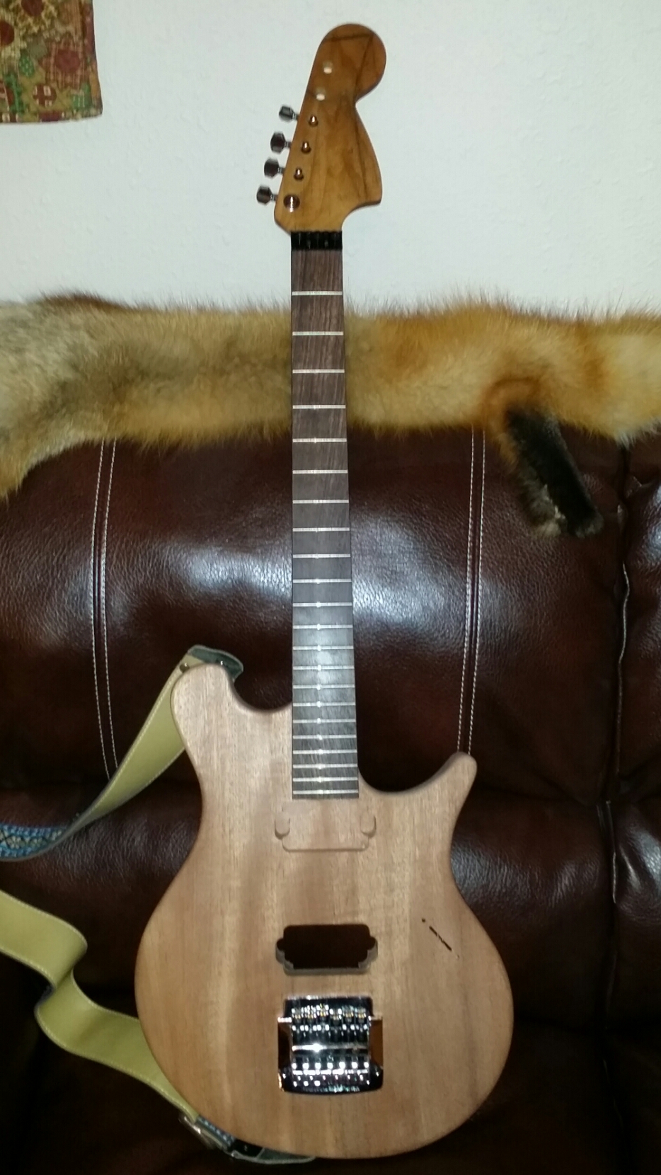

And here we are.

Thanks for the feedback.    I have been thinking about it, and haven't figured out yet.  I may decide to redrill the Kahler, or I may not.  It's inside the range of left/right saddle adjustment, so other than perhaps slightly limiting the max width I could go (and it can still comfortably go 2 1/16th, which is my preferred spacing anyway), the impact of being off the wee teensy bit I'm off is none for all practical  purposes, and it's not visible either - unless you were staring real hard at the bridge and noticed the low E is adjusted full to the top side, but the high E has a 1/16 or so left it could still go south, or if you wanted to do a extra-wide spacing of some kind (which I don't, and this is going to be my personal axe, not for resale)...  But yeah, the 'nobody will know but me / but damn it, I know!' argument has already started in my head.  :)  We will see how it plays out.
I think I agree, aesthetically about the side jack vs the strat jack; it would look better side-jacked.    But on the other hand, I prefer the strat jack for practical reasons (far less likely/easy to bang the cable/jack around), and since I am a knobless wonder for controls (that blade switch rout will be the only control on the guitar), I am thinking that visually it won't be any worse to have the strat jack than it would have been to have 2 or 3 knobs on there, so I'm likely to let practicality win out on this one.    But all my guitar building efforts are (sometimes wildly) fluid works in progress until they get done enough that I stop working on them, so we'll see.

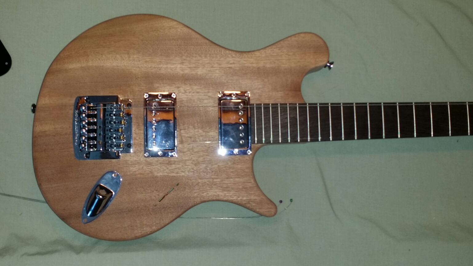

Here's a pic of it more like I am seeing the final; all chrome and wood.  I am going to stain the wood something nice and dark, right now still tossing up between something that's kind of black-ish in hue vs more walnut/brownish (but either one, somewhat dark).      I love dark wood and chrome together, it just makes me feel happy when I look at it.  :)
