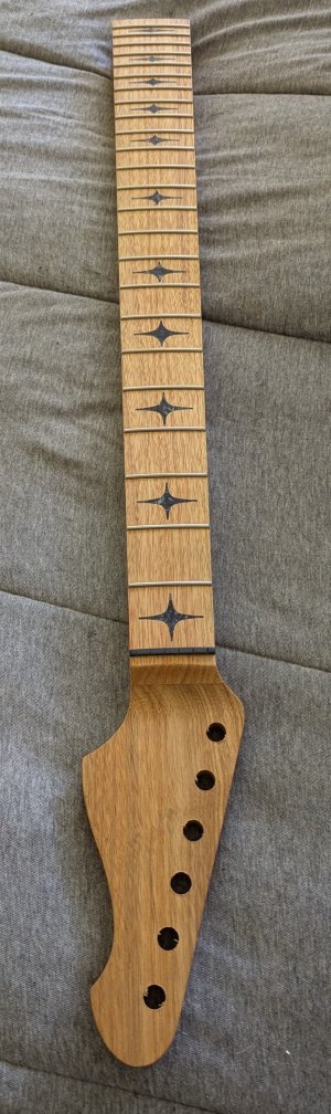

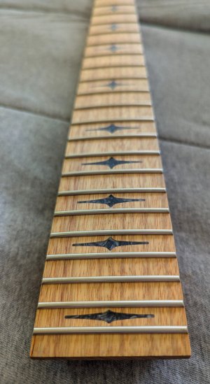

Hey, it has my Supernova Inlays !! I like the idea of P90's Plank of Possibility. How about Dog Ears if you don't like the routing ?

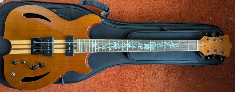

... first, this is my current instrument it's intended to replace:
It's a lovely-sounding guitar (Kent Armstrong humbucking P90s each with push-pot series/parallel, toggle switch, and master tone.
Very versatile but I find it uncomfortable due to fatter neck (like 59), wider nut, and most importantly: barely any edge radius!
It was supposed to have a big 1/2 inch roundover (like 70s Alembic) but I was in a big hurry and it never happened.

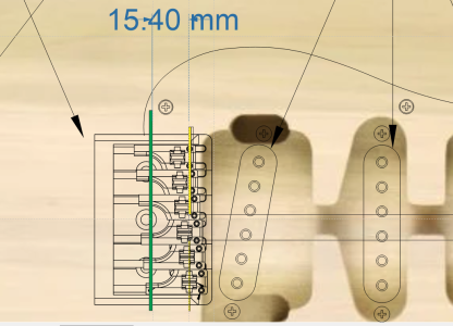

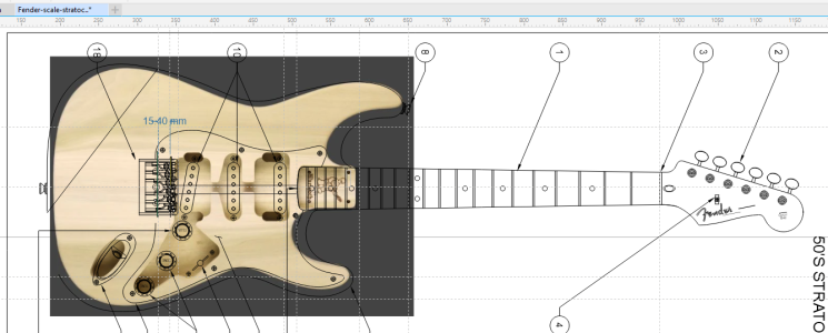

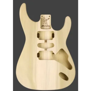

I was reading up on the "new top-routed soloist" offering, and (BEING LAZY) it occured to me that I might be able to pretty easily turn one of those into a sort of "7/8 soloist". And sure enough, the Screamin Deals page was offering a top-routed soloist in a rather attractive extra-lightweight Poplar.
I took a measurement from my 7/8th Strat and saw that the 'end of neck pocket to intonation point' was 164 mm.
I then took the soloist picture (which was shot pretty flat-on) and scaled it into a Strat template I had laying around in Corel draw...

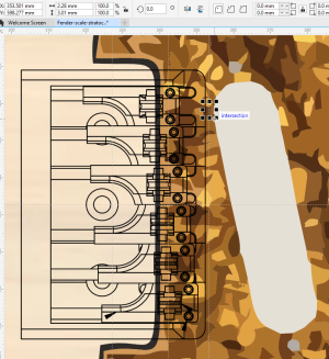

I could see that the theoretical 7/8th intonation point set back 164mm from neck pocket likely clears the standard top-route-soloist pickup routing. A hardtail bridge would overhang that a few mm, but not a big deal with a Schaller 3D which mounts on three sturdy screws further back.... I grabbed a scale Schaller drawing and pulled it in... Looks promising! The 7/8th intonation point will sit about 15.4mm forward of the traditional 25.5 scale,

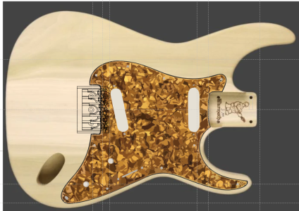

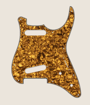

To get a better look I printed the real size Soloist pickguard PDF and imported that into my Corel drawing. Everything lined up OK ( tight, but OK). I took a pic of a gold pearl P/G that I selected in in the site...
And scaled that to match the 'real-size' PG and traced it into an object (in retrospect, I could have just made the background transparent...) :rolleyes:
Anyway, it looked do-able!

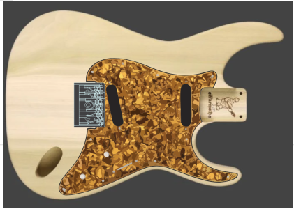

Still, will have to TRIM about 5mm out of the pickguard to fit the bridge in...
But that still leaves a couple mm of pickguard behind the pickup! :-)
Should look something like this:
Anyway, body, pickguard, and a set of 'contoured heel' screws will be on the way soon. Then I will find out how close my guesses really are! Will this be the canary neck vehicle of my dreams???
