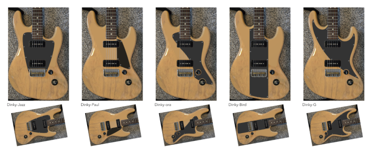

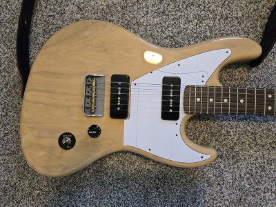

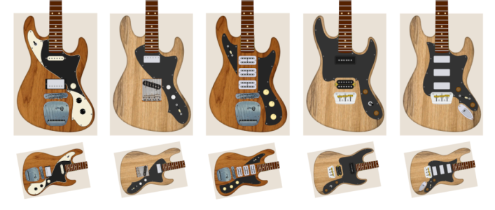

I don't want to totally hijack @sdeeg 's build thread, so I am starting a new thread specifically about the custom Dinkycaster pickguard. @sdeeg originally posted these two drawings:

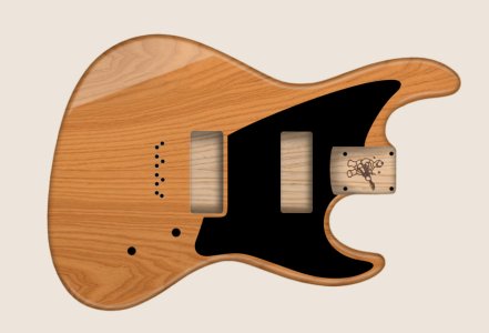

I loved the second one so much that I did this mockup in PS:
@sdeeg and I have talked a bit behind the scenes about his plans to cut it himself, and perhaps cut me one too. I'm not sure I have the skills/tools to do a good job cutting it myself, especially that long curve on the top horn. If it's wavy at all and not a perfect curve it will drive me nuts. So in the meantime I've been looking for a company that specializes in cutting one-off custom pickguards. I've contacted about six companies now, and not one will get back to me. The search continues.

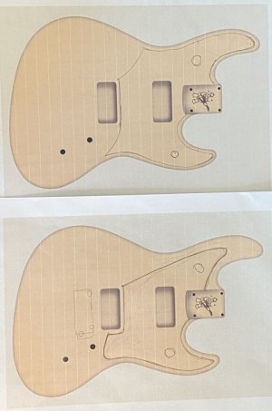

In the meantime, here's what I've done: there is a downloadable PDF on all Warmoth's pickguard pages, so people can check fitment before ordering. The Dinkycaster PDF is done with three single coils, but because I have the sweet connections I was able to get a version of the diagram with two P90's.
I threw it in Illustrator and did a first draft of the custom pickguard shape, then cut everything out to check fit. I can confirm that the location of the top rout P90 in the pickguard diagram matches the location of the rear rout p90 exactly:
The next step is to rework that top horn shape just a bit. The first draft comes too close to the edge of the body, and is maybe a little too long. So I'm gonna rework the shape until I've got it just right.

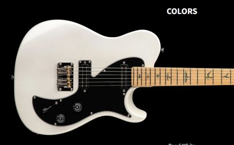

I'd like something like this, and then you can rout out the wood and have easy access to the wiring, not that going in from the back is bad.

I'm going through a few more iterations of the perimeter shape until I feel it's just right. I'll post them here as they get done.
Once it's perfect I'll send you a PDF with the final shape.

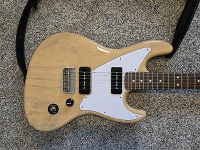

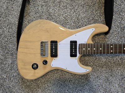

Proto #3.
tumblr_m4u6f0k8wR1rxqiduo1_500.gifv
Looks amazing! Let me know if you hear from pickguardian. Otherwise we can move forward with me getting a template cut. If pickguardian can do it, I'll take 3. :cool:
