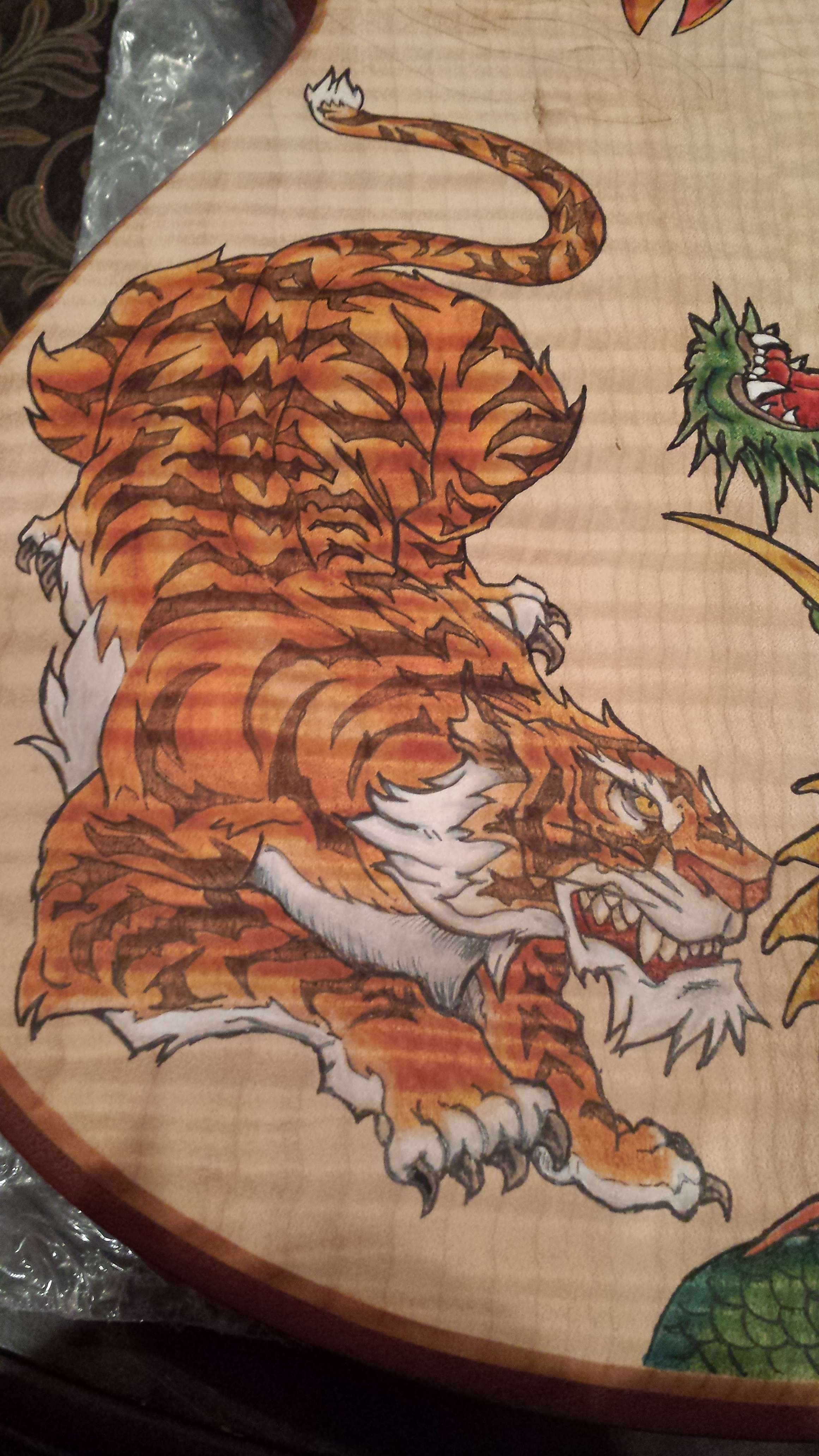

Where did you find the dye pens, and how did you prevent them from 'bleeding?

They are Prismacolor Illustration Markers. Basically alcohol based dye in a marker. I found a used set of 60 on Ebay. I really only sealed the natural masked edges. It seems just a perfect amount of dye comes out as you draw. I really didn't do anything to stop bleeding. It even has a colorless marker for blending colors. To really saturate and area you would have to continually go over and over it again. Bleeding wasn't a problem at all. The fine lines are black ink and the white is thinned enamel to soak into the wood. I hope this helps.

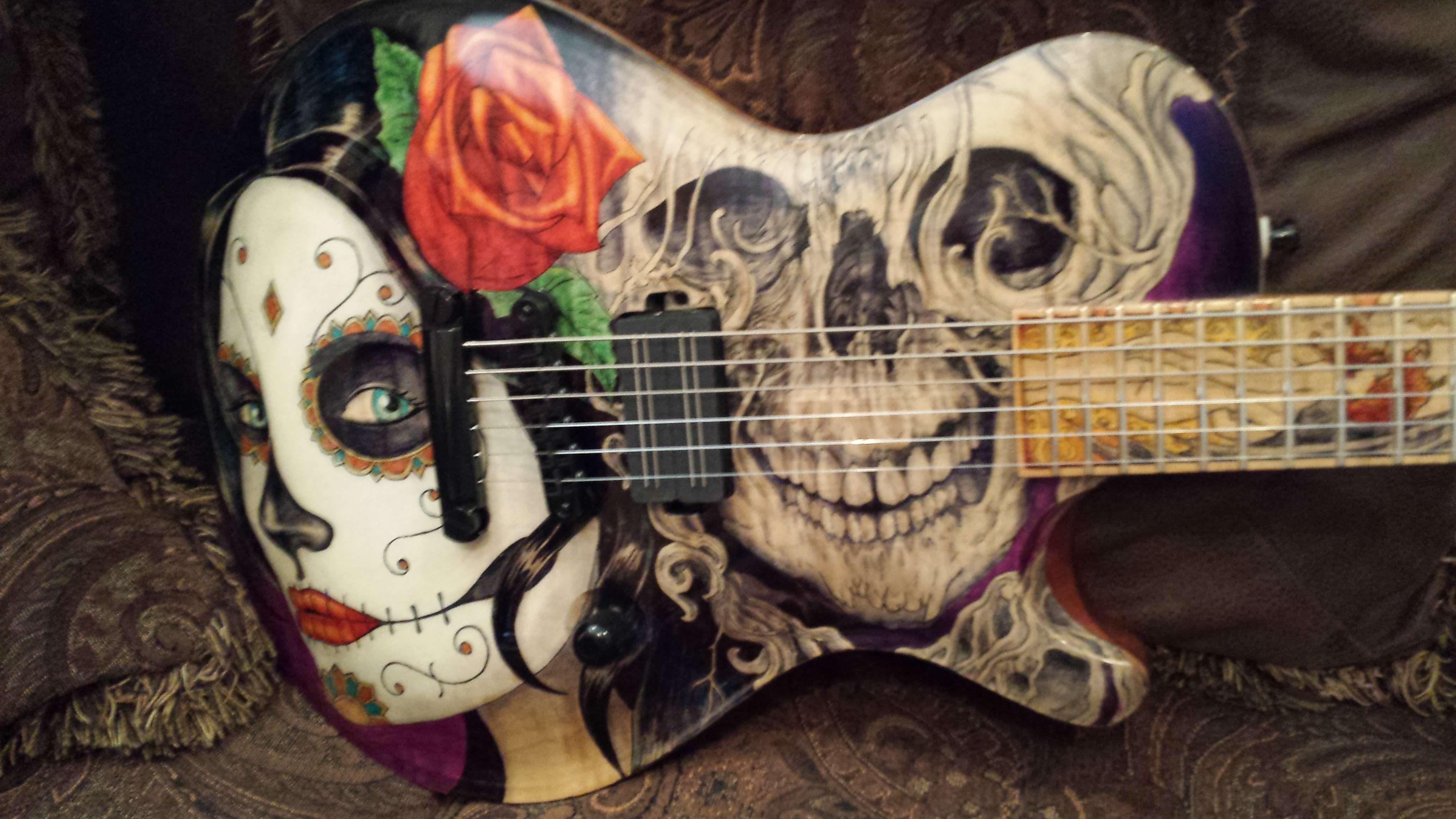

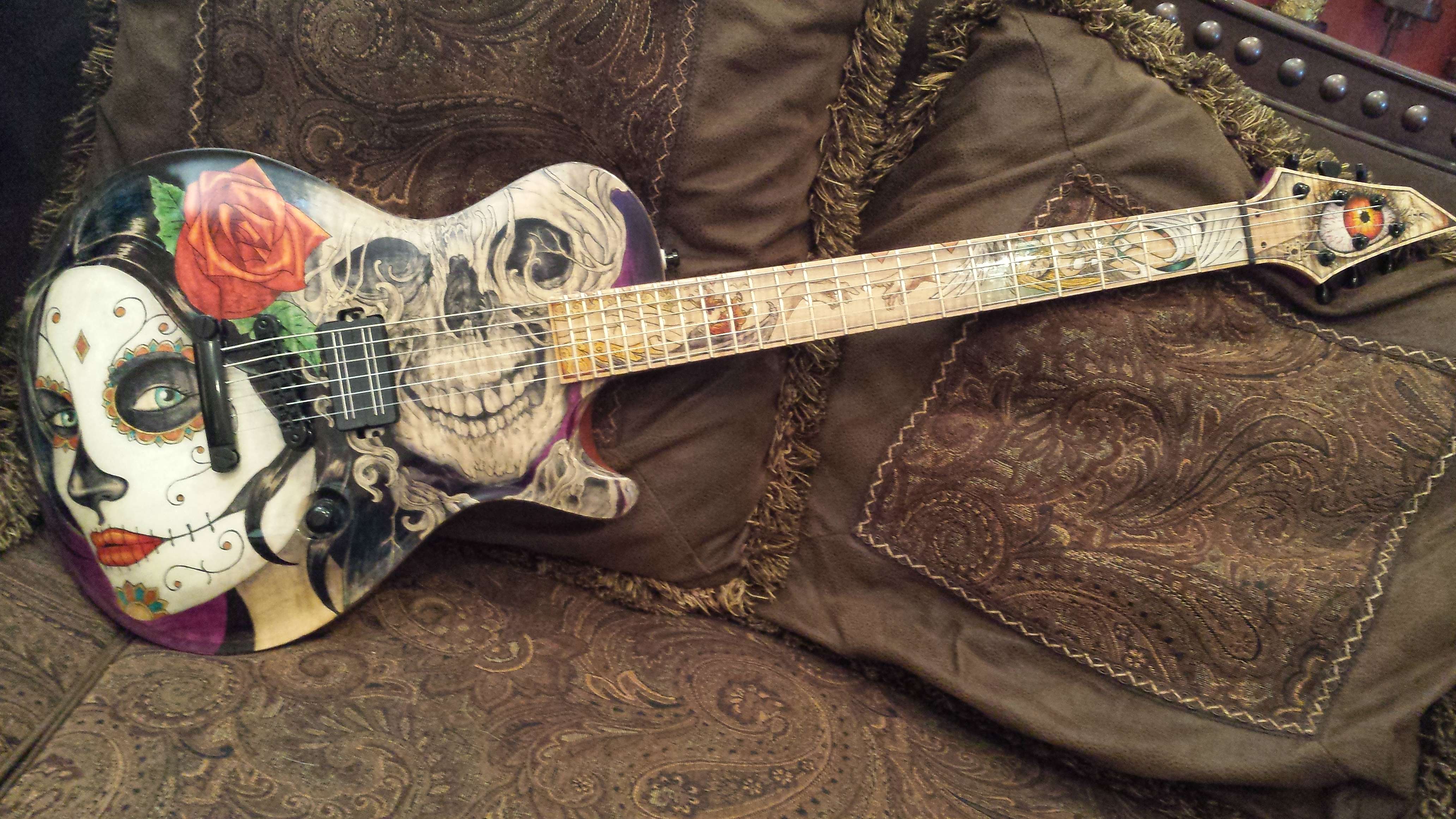

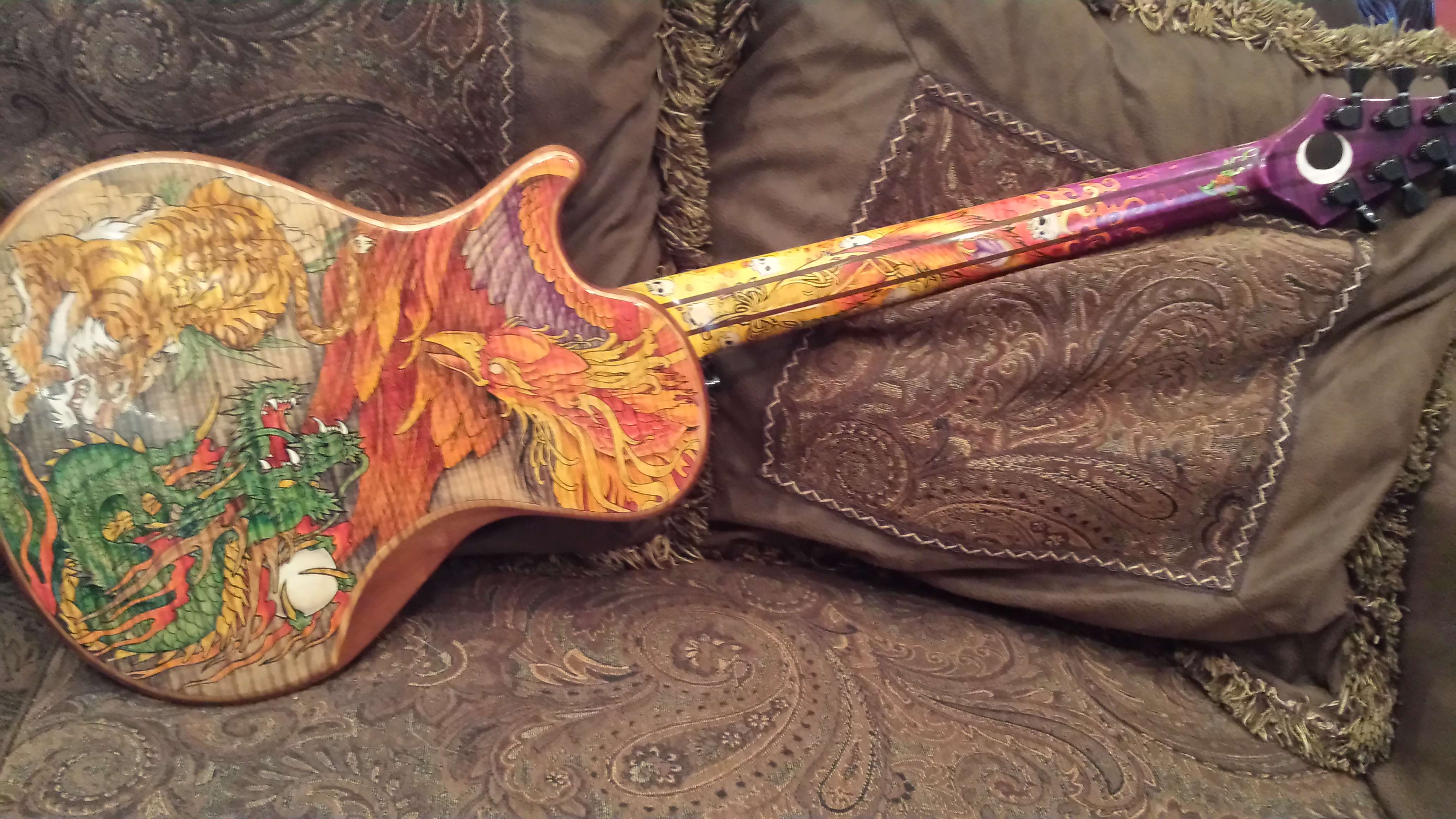

She's finished... phew!
Hipshot Griplock locking tuners. Black Tusq nut and saddles. BKP Black Hawk.

That is amazing.  I must admit I was a doubter.    But the artwork is beautiful and I love how the flame shows thru it.
Only issue is I would be afraid to play it.

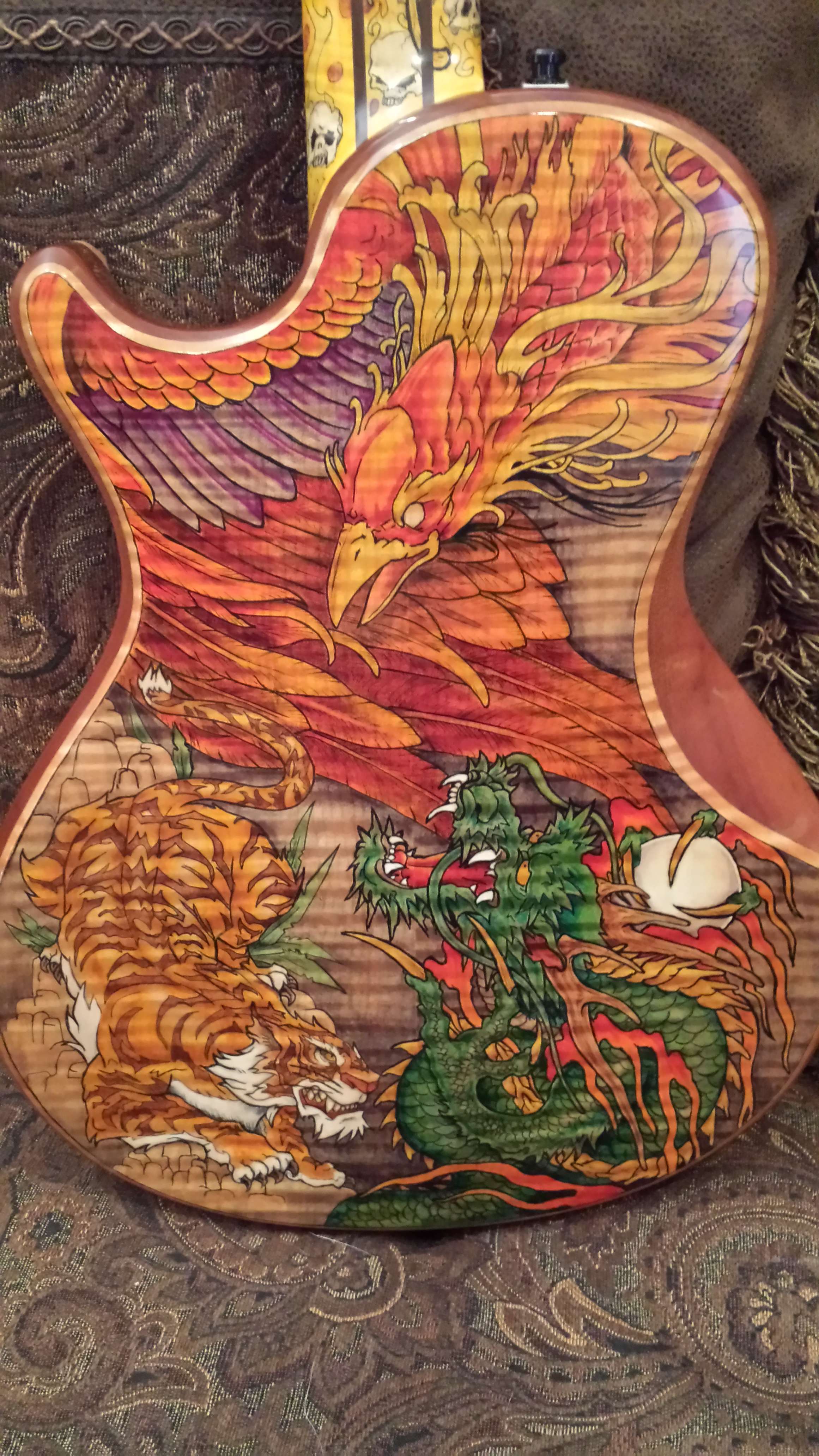

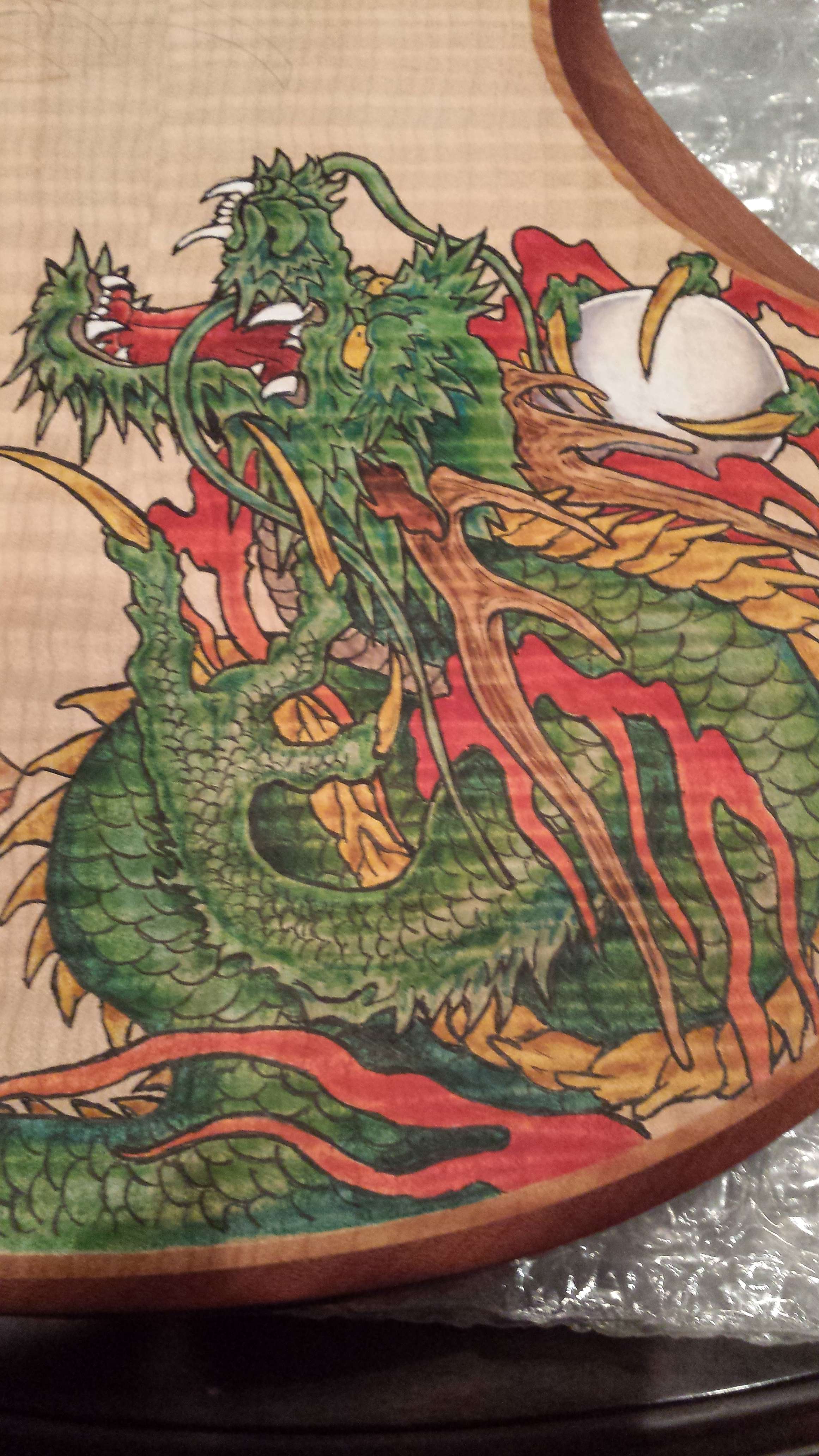

Been busy with the back and got it done today. Here are some in progress pics I took first.
Here it is done: No sealer yet.
I don't think I can possibly dye another piece on this guitar before going insane.
I'll glue it up tomorrow.
great work , what kind of paint did you use ?  ink or acrylic ?

Thanks, It's Prismacolor Illustration markers. I got a set of 60 of Ebay for cheap. They are alcohol based dyed in a marker. The black is ink and the white is a thinned enamel.

Thanks, It sure did. I did it in sessions whenever i could fit in the time. The back I did on a Saturday with nothing to do. It seriously took all day. I hadn't noticed the sun had went down and my wife asking if I was going to be hunched over it all night too.
