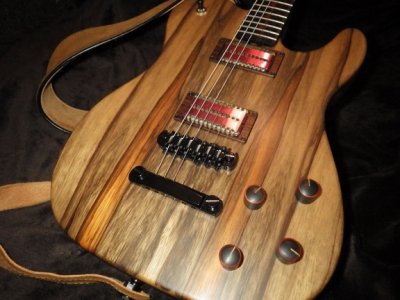

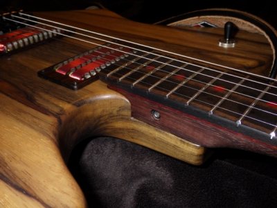

Here is my dream come true guitar
KREB- Korina, Rosewood, Ebony, Bloodwood
Body: Solid Black Korina with unique choice Black Korina top. Satin finish.
Neck: Rosewood with Ebony fingerboard and bloodwood laminate underneath. Beeswax finish.
Bloody basin jasper dots and mother of pearl side dots.
Stainless fretwire
The pickups are rare original Q-Tuners unlike the current ones which do NOT have variable Q-factor.
These ones are extra rare because I had them made with coil tapped outputs.
These are basically air core sidewinders with rare earth magnets.  They are wood mounted and set up with four push/pull pots giving series/parallel, shunt and out of phase sounds.  They are super noiseless and sound incredible.
David King made the knobs, switch tip and pickup rings.  Knobs are ebony with bloodwood laminate to match the neck lam, and korina indicator lines.  Beeswax finish.
Rings are rosewood with beeswax finish.
Switch tip is ebony with beeswax also.
David does very nice work and is great to deal with.
The guitar has amazing sustain and tone.  I am very happy.
