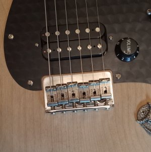

Did this on the 1st one and slightly tapered down to low E on the others. E and B are fairly in the same spot on all of mine.DMRACO said:just curious when placing a bridge on a 24.75 scale neck, or any other neck for that matter. When using a strat style bridge, what process does everyone use?
I usually set all the saddles in the middle of their adjustment range, measure the scale from the nut and place the bridge appropriately with the saddles on that measurement.
I figure the high E will have to be moved a bit closer to the nut while the low E will be moved towards the bridge. What is everyone else doing for builds that don't have the bridge holes pre-drilled??

Angling a hardtail bridge to get proper intonation without string, screw, saddle interference sounds pretty extreme. Aren't the Fender hardtails all string through not top loader so is it even possible without major mods?
Yeah my question was because of this statement...
"I'll probably leave the high E side bridge plate attachment screw in place and move the low E bridge plate side back approximately 1/8" to achieve proper intonation adjustments according to my measurements"
I did not go the angled route however I moved the bridge back and obtained the results I wanted...lots of work. And besides it would have been a never ending line of people telling me my bridge was crooked. I updated post with details. Thanks to all for the replies.I've never tried a conversion neck (maybe next screamin' deals blowout? lol) but this sounds like something the good folks at Warmoth would assist with.
Am I reading this right? Angling a hardtail bridge to get proper intonation without string, screw, saddle interference sounds pretty extreme. Aren't the Fender hardtails all string through not top loader so is it even possible without major mods?

Thanks for explaining. I'm glad you got it how you want it now.I did not go the angled route however I moved the bridge back and obtained the results I wanted...lots of work. And besides it would have been a never ending line of people telling me my bridge was crooked. I updated post with details. Thanks to all for the replies.
Once the bridge is relocated and secured use an appropriate size bit to drill the string holes at a slight angle. You should see clean bores through the ferrule openings when held up to a light. Strings bend over the bridge plate bores so those spots cannot be scatched, etc.Thanks for explaining. I'm glad you got it how you want it now.
Do you happen to have before and after photos of the bridge holes?
Do you mean once the bridge was mounted further back, you drilled from the top down at an angle to connect to the existing string through holes?
