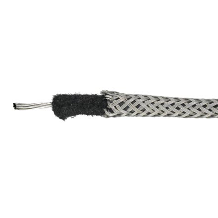

Trimmed back to necessary length, and use shielded cable like this...
The braid on the outside is connected to ground, the inner wire is used to conduct signal.
And i should use shielded wires for which connections?  The bridge is just a ground wire, no shielding needed.  I could do this for the jack wiring, but I'd probably want to replace the jack rather than unsolder what's done.  I'm having a problem with the idea of clipping the wires from the pickups...  I don't mean to sound confused, but I am.  I'm not seeing a lot of jazz basses with shielded wires.  Just a lot of talk about copper shielding.  I'm with you on that, I don't see much benefit from shielding the cavities.
You only need to shield wires that will carry signal, not including return lines which are also ground. And the reason you don't see many Jazz Basses with shielded cables is that they use single coil pickups, and there's nothing you can do about shielding those. Traditional Strats and Teles are the same way. That's why there's been so much effort over the years to create noiseless pickups that look/sound like single coils.
