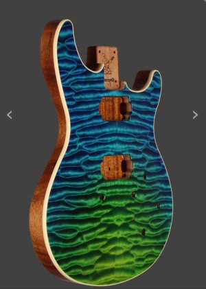

Ha ha, thanks. So I already have a few 'Superstrats' and my David Gilmour Black Strat replica, so I'm wanting something different. I have come to enjoy playing my Les Paul the most over the years, so I'm thinking of a double cut Les Paul style, similar to a PRS 594. So.....
VIP Carved Top Body
Mahogany Core Wood
Quilted Maple DL or Unique Choice
Humbucker
None
Humbucker
Strat Controls
Hardtail
Gotoh Wraparound
White Binding
No Finish
I'm going to do a Blue Dye Burst with all black hardware and Ebony Fretboard (Still deciding on the neck). I've been practicing dying some scrap maple and have gotten pretty good at the burst.

I really want this to be special, and I'm worried about the quilted maple I may receive if I just pick the standard Quilted Maple DL, but the Unique Choice is going to put this body over $850. Any experiences people have with the regular quilted maple DL would be appreciated.
The dims on the Gotoh wraparound route are very close to what Schaller publishes for their dims, but not exact. Does anyone have experience using this bridge on that route ? I would really rather install my own studs, as I just want to do as much of the build myself as possible, but would it be safer to send the bridge in to Warmoth ?
Off-the-rack quilted maple is going to be plenty attractive. If there's something that just calls out your name in the night, yeah, it might be worthwhile to pay the extra tariff; but the Warmoth crew don't disappoint when left to their own devices.

My very limited and old (2003-04) experience with Warmoth's figured maple is, in a word: generous. This goes for both bodies and necks, quilt and flame, standard and 3A requests.
My first build with standard quilt was probably at least a 3A figure. For my second build, I requested a very subtly figured top as I wanted more of the wavy grain rather than the curly figure (this was before Unique Choice when they had a "hand-picked" option; for $25 they'd select a plank that most matched what you wanted from what was on hand that day). I got a top that was a bit curlier than I wanted but was still stunning. I can provide pics of both if it helps.
FWIW, Warmoth now uses descriptions like, "high," "very high," and "super high" grade on the Showcase but "3A" and "5A" in the builder. I think there's a post around here that explains this? Also, I have trouble understanding how they grade figure sometimes. I've seen pieces that look 3A+ to me but are listed as standard grade, and some that I think are very high but listed as high grade. It must be an expert skill, like wine tasting or gemstone selecting 🤓
It's hard to justify the Unique Choice price tag sometimes. What ends up swaying me to bite is knowing that I could have that guitar for the rest of my life, whereas I've bought solid vehicles for the price of a build that lasted only a fraction of the time. That and, if I don't spend it, some faceless company or Uncle Sam will spend it for me on something I'll never have :LOL:

The Schaller Signum dimensions are close enough to the Gotoh wrap around rout to be for practical purposes the same for the width between the mounting studs. The Schaller bushings may work but for a better fit, it might be worth sourcing some Gotoh Wraparound stud and bushings, suitable for M8. Use the Gotoh bushings in the body and then use the M8 posts from the Signum. That is the approach I would go with.
Thank You, great info ! So as long as I am comfortable installing the studs there is no advantage to sending in the bridge ? I see they mention angling the neck pocket for the gotoh option, not sure I understand that.

If the body is finished then it might be worth letting warmoth install the studs, if unfinished, you need to make sure you insert them preferably with a press so that your studs don't screw in sideways and also dont forget the ground wire. I have never had studs installed for me, but I also have ran into all the above pitfalls

There may be no advantage if you are comfortable, installing the bushings.
Certain bridges such as Tuneomatics and the Gotoh 510 fixed bridges need an angle in the neck pocket so that the neck is pitched to accommodate the higher height of those bridges compared to flatter bridges. Gotoh 510 in this instance does not apply to Gotoh 510 tremolo bridges, which are flatter designs.
