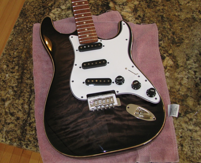

In the spirit of it not being true if there aren't pictures;
You can't tell from the picture but I did put a treble bleed on it, and there are some solder tabs between the pots and the shield. The tone cap uses one along with the pickups and trem ground.
And one more of the body showing it in another light, making it look even more brown. I'm intrigued by how black it looks sometimes and how brown it looks others.
Curly and quilted maple both have an iridescent quality to them that causes their appearance to change depending on the angle you view them from, and cameras aren't as easily fooled as the eye. I have a Les Paul copy here with a curly maple top where the camera invariably returns different images than what I see. At some angles, it almost looks like there's no curl, and at others it's exaggerated. It has to do with how the reflections and shadows are percieved vs. how they're recorded.

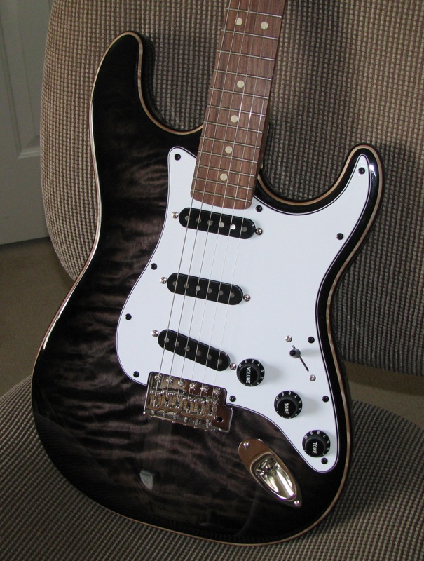

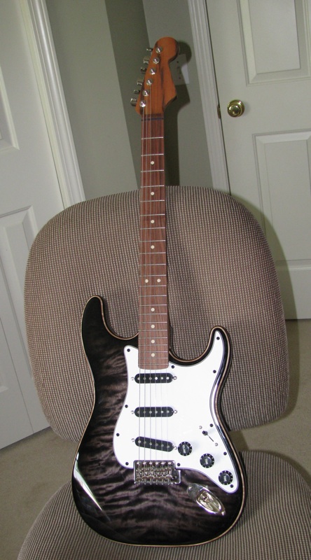

I need to clean it up and take some better pics before posting in the completed section (along with mount the trem cover) but... it's in tune, it makes noise, and aside from a few details like strap lock buttons, a trem cover, and a pro set-up, it's done! I'm not 100% sold on the white pick guard but this it waht it's going to look like for a while anyway.
i think you should keep the white pickguard because it enhances the figuring of the rest of the guitar
sweet build!  :headbang1:
