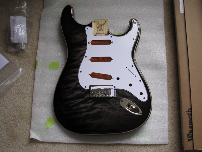

The screws that hold the pickups in place have an angled base, for a countersunk hole. Screws for the switch are countersunk too.
The pickguard only has countersunk holes for it's mounting screws, not for the pups or the switch.
Should I countersink the holes for the pups and switch too?

Oh yeah, one of the Fender pickups doesn't fit in the GFS pickup cover either. The poles aren't quite perpendicular on any of them, but on one it's off enough that they won't go in the holes. Also, the spacing is ever so slightly off between the GFS covers and the Fender covers. FWIW - the Fender covers don't fit quite right either, they foul the wires and need to be shaved a bit to sit flush on the base of the pickup.
Nothing that isn't easily fixed, but still... I'm hoping taking the holes out a touch so there's more clearance won't annoy me like the non-countersunk holes do! Luckily the pickup is black too, so I doubt enlarging/ovaling the holes a little is going to be noticable.

Let me put it like this: If you don't countersink all those holes, God's gonna to kill a whole raft of puppies. And not just any ol' puppies, either. I'm talkin' Bichon Frise puppies...
Please... countersink your pickguard holes!
It's sad, isn't it? So, don't be cruel. You can countersink your holes very easily, and it won't take hardly any time out of your day at all. Plus, everything will look a lot nicer, too.

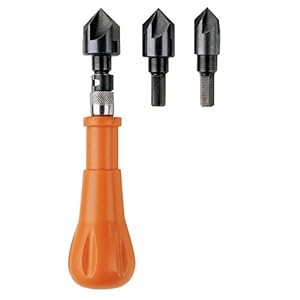

The tools aren't expensive. You can get a countersink bit at the local hardware for between $5 to $7. That's less than the cost of double quarter pounder with cheese, small fries, and a coke. If you don't have a drill motor, you can get a 3 bit hand-driven countersink set from Amazon for $5.
I question the quality of it at that price, but it's not like you're going to use it for production purposes. If it lasts for one pickguard it's paid for itself, and I'm sure it'll go longer than that.
