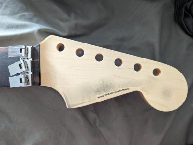

Bill Edwards 1 3/4" locking nut, ebony fretboard, custom waterslide.
This will be a hardtail.
The only thing Jazzmaster about it will be the body shape and upper controls. According to a bandmate, it's completely ridiculous. A hardtail with locking nut and locking tuners makes him cringe. For me, it's all about the convenience of fast and easy string changes and tuning stability. I actually have 2 similar Jazzmaster builds going on at the same time but this thread will be dedicated to the Warmoth build. The neck, body, pickguard, and most parts are from Warmoth. This will not be gigged in my band.
The other build I took an existing Jazzmaster and doing a very similar config (minus the locking nut and 50's style jazzmaster controls). I'm going to finish this one first to see if I like the 3 way freeway switch. If I do it will change whether or not I make additional cutouts on the Warmoth pickguard.

The locking tuners allow me to restring a broken string in less than a minute. The locking part grabs the string so you don't need a bunch of winds and it cuts down on binding issues when making the strings do funky things. It's purpose for me is easy/fast string changes only. I have the same tuners on all of my guitars now. They aren't really any cheaper to NOT get locking tuners.
The locking nut eliminates any potential for string binding at the nut. The Bill Edwards locking nut keeps the string changes fast.

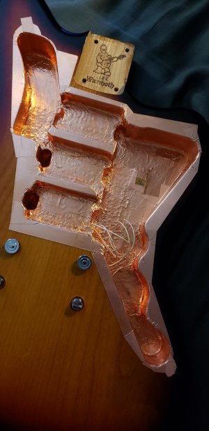

I do have one more pic as I dig through my phone. I don't have a middle pickup planned but figured I'd cut it in "just in case." All I had was the narrow copper tape so I used what I had. It's ugly but will work and nobody will see it when it's done.

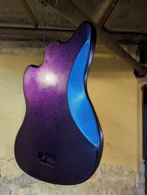

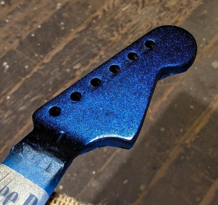

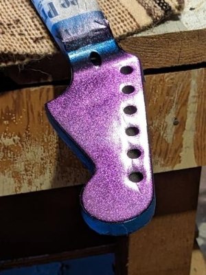

So I got a few layers of paint on the headstock of JM#2 (this is the refinished Jazzmaster where I'll be testing some things before I complete my Warmoth build). I learned a VERY valuable lesson on JM#2. Wet sanding when there are pre-existing drilled holes leads to cracks in the wood and existing finish. Oh well, it is what it is. The pickguard is going to cover them up for the most part (at least I think).

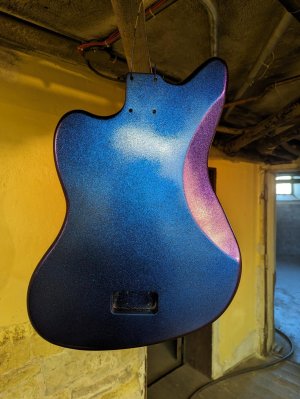

I had to stand at a distance to get the color changing effect but you can sort of see it. I hope the body shows it better.
Have a few coats on the body now. I'm not good at painting stuff but it will look decent once I get some clear and the hardware on there. As it'll be my main gigging guitar it's going to get banged up eventually anyway.
Looking forward to getting this done so I can finish the Warmoth build (with a professional finish).
