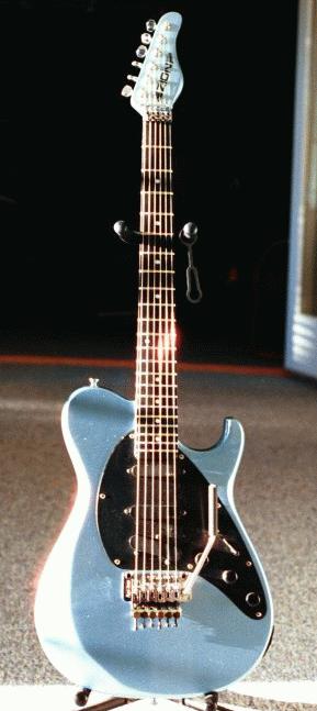

Wow! That is one sharp-looking fiddle! Leo's gotta be turning over in his grave, though. The only thing Tele about that Tele is the body outline. But, that's what makes it so nice! <grin>
Back in the eighties, Zion guitars (then out of Greensboro, NC) had a set neck un-Tele called the Power Glide.  This one is a particularly unique one, with the EMG Tele bridge pickup on an otherwise super-strat like configuration. Set neck and a Floyd ought to cancel out any traditional tele points  imparted by the bridge pickup. (That and having belonged to one of my favorite guitar players, also a warmoth owner.  It also happens to be one of the first hits that comes up for Zion Powerglide)
