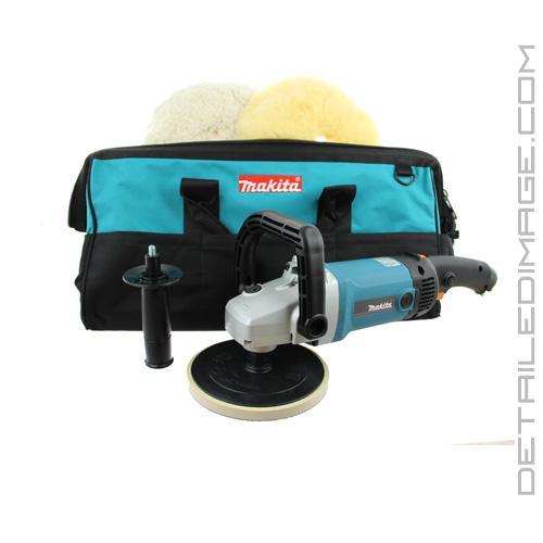

When I did the L5S, after two weeks the finish was ready to abuse. I started with 600 grit, and gradually worked through 800, 1000, 1200, 1500 and 2000 grit papers. At that point, it was ready for buffing. I used StewMac's Colortone compounds, just using the medium, fine, and swirl remover grits. Those I applied with with a Makita 9227C buffer...
That unit has the hook & loop pad attachment Tonar mentioned. Allows for easy changing of the pads. I used wool; foam works too.  Be sure to get a pad for each compound! You can't change compounds on a pad, or you're wasting your time. Get to the finer grits, and you'll still be rubbing in the coarser grits, which is defeating your purpose. Finally, some Meguiar's Ultimate Liquid Wax hand applied & rubbed out. That got the finish to this...

Also, using a hand-held buffer like the Makita shown above is pretty much a two-man job. When that buffing wheel contacts the part, it wants to throw it. You can do the front and back on your own if you've got a router mat to hold the body in place, but the sides really require somebody to hold the thing in place.
