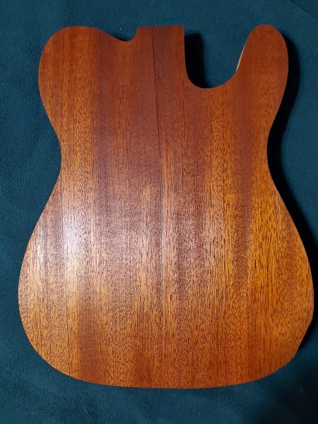

It's a solid one piece chunk of Khaya, otherwise known as African Mahogany, 1 3/4 thick. I'm kinda thinking maybe a double cutaway Tele........... :icon_scratch:
Bum deal about all the tear-outs and such. But, I'm looking forward to your khaya body. That's a nice piece of wood and at a good price. If it behaves like Brazilian mahogany, it'll be a dream to work.
Yes, the redwood was aggravating, but such is life. I am happy about the sweet find on the khaya, I've used some before and it wasn't bad to work with at all. Now I have to go into deep thought and come up with a whole new plan, or just proceed with the original plan which was no plan at all. :cool01:

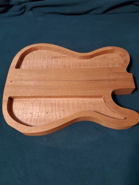

All right, after the unfortunate redwood incident,(Of which we will never speak again.) I have substituted the khaya body and I believe we're about back to where we left off. Made a better chamber template and fought sawdust and chips for awhile. The routes are .800 or a little over three quarters of an inch deep. The blank is 1.730 thick so it's close to halfway. I think I'll stop there to allow some contouring on the back.
With the korina top the whole thing will be around 2in thick. A little more than a standard tele, but about the same as a Les Paul if you count the belly thickness on the Paul.  Should be a lot lighter though from being semi-hollow. We'll see.
Rgand said:
Nice. You probably won't need a block under the bridge, either.
Shouldn't need it with the mahogany. I made the center block a little wider too just to be sure. Now I'm trying to decide what kind of f-hole to put in the top. I have a template for the standard kind, but I'd like to do something different. Bear claw type slashes have been done to death. Maybe some circles, but those have been done a lot too.  :dontknow:  I'll have to ponder it awhile. :icon_scratch:

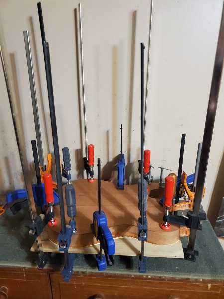

"Scotty, I need more clamping power!"
"But Cap'ain, she canna stand the strain!"
"Blast it Scotty, just get me more clamps!"
"(Sigh) Aye, Cap'ain."
