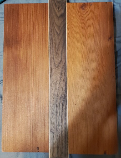

Some surface sanding and a little naptha and we start to get an idea what the back will look like.

Thank you. So far I'm a happy camper. What I'm wondering though, due to the fact that the sides are each two pieces, is how the grain pattern on the sides will look. No way of really knowing until the body shape is cut. Keeping my fingers crossed.

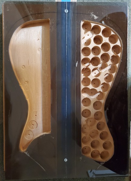

While waiting on the body templates I ordered to get here, I made a quick and dirty template for routing the hollow body pockets. Following SOP by hogging with the forstner bit, (Let us all take a moment to give thanks for the miracle that is The Forstner Bit. :hello2:) then routing just short of finish depth. It's not going as easy as I'd like because my router's base is a little small, but I don't have the material on hand to make a larger one. This will be rectified in the future. However, so far it's working with careful balancing and a lot of cussing. Anyway progress is being made..

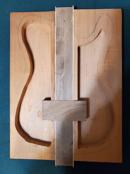

A little more progress. I flattened out the bottoms of the chambers and decided I wanted something more dense under the bridge than redwood, so I put a piece of walnut in there. Still have to surface it all a little. Still waiting on the templates to go further. Don't really have the tooling at this point to properly make my own, so I had to order some.

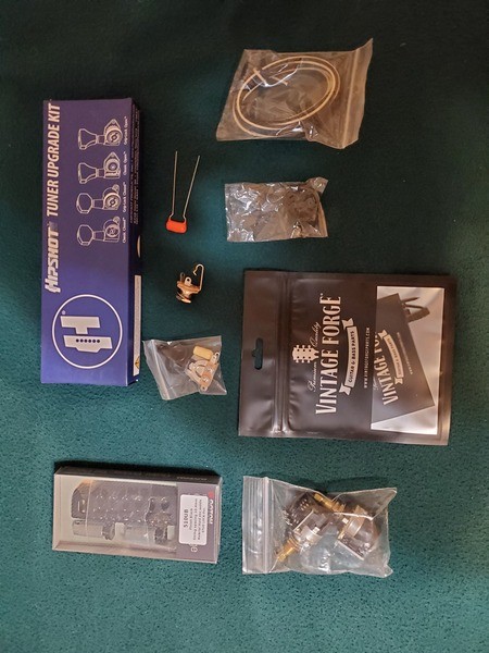

. I have received some of the other parts though so I'm happy there.

You're coming along nicely. That's a good idea to put the walnut block under the bridge.
Thanks. Yeah, while the redwood seems nice and resonant it's still a rather soft wood, so I felt that something harder would be better. It's getting a Gotoh 510 wraparound bridge, so those posts need something dense to grip on. I'll also have to angle the neck pocket a degree or two to compensate, but that shouldn't be a problem. I'm happy with how it's coming along considering the situation we're all in right now.
