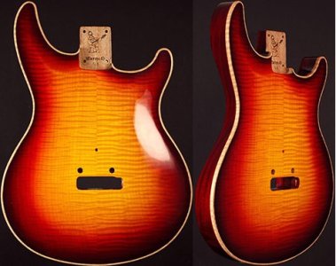

Well, I ordered a VIP body from the Showcase - VIPP106 - PRS controls (all 3/8" dia.) with HxH pickup route and 1/2" Jack hole.
Ordered a 25 1/2" scale Bubinga Neck (Wolfgang contour) with Pau Ferro Fretboard (Rounded end with Mother of Pearl inlays) and Warmoth headstock.
I will be installing DiMarzio PAF Pro in the Bridge and DiMarzio PAF Joe in the Neck - each pick-up will have a 3 way toggle to switch between South coil - Humbucking - North Coil.
Pick-up selector will be a rotary switch (4 pole / 6 position):
  Position 1: Bridge Only
  Position 2: Bridge / Neck (Parallel)
  Position 3: Neck Only
  Position 4: Bridge / Neck (Serial)
  Position 5: Bridge / Neck (Parallel out of Phase)
  Position 6: Bridge / Neck (Serial out of Phase)
1 tone and 1 volume pot will round out the electronics - if my math is right, this arrangement will give me 42 different combinations of pickup config / selections.
Wilkinson Tremolo - GraphTec Graphite Nut - Planet Waves Auto trimming tuners - Schaler Strap Locks (All chrome) along with chrome pick-up mounting rings (care of StewMac).
I can't wait for this beast to be here and built!
Eric "Soon-to-be-WarmothGuitarEC" C.
