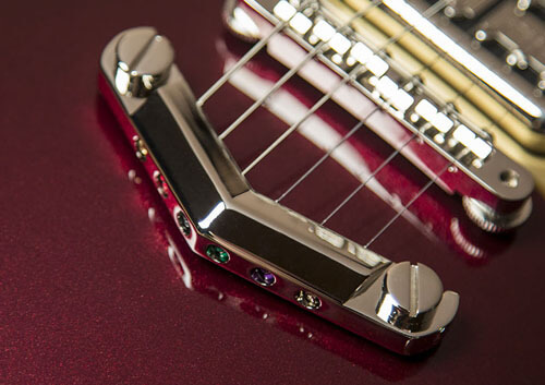

I'm going to start a project in the not too distant future and a friend half jokingly suggested this tailpiece to me. I actually like it and might use one if I can find out if it it works. From what I've found, the stud holes for this are 18mm whereas the ones on the standard Warmoth Tune-O-Matic/stop bar are 11mm. I can't find measurements for where the tailpiece wraps around the stud and am wondering if it would work. The other thing that's different is the spacing overall is a half millimeter wider. Is there enough wiggle room for that to work? Will studs drilled for the 11mm Warmoth uses work? I'm not dead set on this and if it doesn't work, I'll go for either a string through or stopbar. If I know it'll work, I'll then figure out how much I want to use one.
Here's a Reverb listing that has some measurements.
https://reverb.com/item/23154321-770-9343-000-gretsch-nickel-v-stop-chevron-guitar-tailpiece-streamliner
Hi and Welcome to the forum.
I would be surprised if anyone has used one and is able to give you a definitive answer.
Per the measurements at the Reverb link you posted, I am not sure where you have 18mm for stud holes.  The dimension in red I have added below.
Studs measure 15/32" (11.9mm approx)Diameter. Tailpiece slots measure 3-1/4" (82.5mm) center to center; 4" (102mm) Total Width; 29/64" (11.5mm) Thick.
Would it fit?
The best bet would be to order the Warmoth body with a Gotoh or Tone Pros tailpiece and have the studs installed. There is a good chance that the V shaped Gretsch version will fit on those studs and inserts. If you are in the US and the shipping is reasonable it is probably worth a punt for $30. If for some reason it did not work you already then have a tailpiece ready to go.

I was thinking of using Tonepros anyway and have them install the studs, maybe I'll order one and take the chance. If it doesn't work, I'll just use the Tonepros. I was thinking about it and I don't mind not having a locking tailpiece, it's the locking bridge that I'm really after.
I accept your caveat as well. Although it would be nice if someone could say for certain, I know this is an odd question. I'm also still really thinking about the string through as well, that way no tailpiece needed and I can get the locking bridge by itself. I was also really tired when the whole idea of this tailpiece started, now that I'm more awake, I'm not sure I'm feeling it as much lol.
I am pretty sure it would work as I described but obviously I can not provide a guarantee.

Well, I decided to go for it. I went ahead and ordered the tailpiece, I thought I'd should get one while it was available. The more I think about it, the more I think it's worth the chance. Would there be any reason I couldn't use the Gotoh tailpiece with a Tonepros bridge? I don't mind not having a locking tailpiece and it'd save me some dough. I think that'll be my last question on this subject haha. I really don't know why this became such a hard thing to come to a conclusion on. Making the order committed me to Tune-O-Matic/stop bar. Either way it goes, I know I'll have something that serves me well.
I've got an idea if the Grestch doesn't work on the Switchback, if it'll work, I'll put it on my Firebird instead. I think it'll fit in with its style and it's  a Firebird V so it seems all the more fitting.
There is no reason why you cannot mix and match Gotoh TOMs and tailpieces. Or any other for that matter as long as they are compatible fit wise.
I couldn't come up with any reason not to be able to mix and match as long as everything's the right size. From what I've been able to gather, it'll work just fine. I only ask because there are times when something seems like it should work but it doesn't for reasons that never would have dawned on me haha. That's the plan then. I wouldn't mind paying up for the locking tailpiece if that was what I wanted but since I've got another in mind, it's hard to want to pay that much. I feel good to go on the bridge now.
