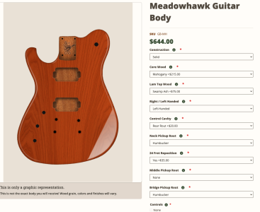

I’ll start with the body (screenshots below with the specs):
I’ll wire it as follows:​
bridge volume (push-push)​
neck volume (push-push)​
tone - only for the neck​
is it possible to have just one tone and have the bridge tone 100% “open”?​
With push-push pots do I have a visual indication that, for example, the split of the pickup is activated?​

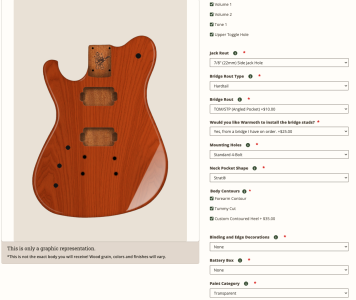

Bridge:​
I wanted a Gotoh 510, but I cannot find a left-handed one, so I gave up and I’ll go with this (both gold):​
- TonePros Tune-o-matic bridge​
- TonePros stop tail piece​
do they fit baritone strings? The option for the bridge route is correct?​
Jack route: I don’t understand what I should order/do, any advices?​

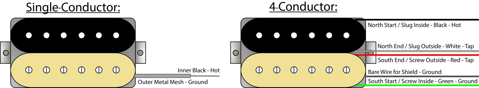

Pickups: I’ll decide later, but 90% they will be a Dimarzio Super Distortion and some kind of PAF. I’m looking for some Tim Shaws (I have them on my Gibson custom 1981) but they are hard to find. 100% I want them to be both splittable.​
I do not need to buy the F-spaced pickups, correct?​
Colour: on the bottom, “satin or gloss” option is missing. It will be gloss.​

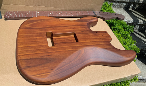

I want something similar to my Schecter PT Van Nuys but slightly darker, should I get maybe roasted swamp ash? Does somebody has a pic of a (roasted) swamp ash build in transparent amber/red/vintage tint/brown?​

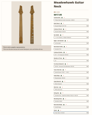

Neck (screenshots below with the specs):
I cannot find anywhere the length scale of a Warmoth baritone neck. 28 inches?​
Tuners: I cannot find locking tuners that will fit baritone strings, so I picked the Gotoh SG381 3+3 set (in gold), should be ok I guess..? No staggered posts needed right?​
Frets: I don’t understand if I will need to do a fret job after the next has been put on the guitar with strings or not even with stainless steel frets (probably just a language barrier).​
What exactly do I need to buy to file the nut for a baritone?​
Roasted maple: if I understood correctly, I DO NOT need to apply anything else (hard finish) more than the finish I want Warmoth to apply right? I just need to polish it from the frets and the neck is good to go…?​
That’s it I guess, thank you to everybody in advance.

Bridge: Yes a Tonepros tuneomatic should be fine with baritone strings, no problem here
Jack route: 7/8" route is the standard/most commonly used and what I recommend. 1/2" is for use specifically with deep panel jacks. 3/4" is a tight fit for regular style jacks.
Pickups: For a humbucker to be split-able you need it to have 4-conductor wiring, that is four wires coming from the pickup. To my knowledge Gibson Tim Shaw humbuckers are not like this, they have a single wire with a braided ground wire, and so cannot be split. I would recommend something like the Dimarzio 36th Anniversary as a Dimarzio pickup that might have a similar sound and comes stock with 4-conductor wiring
Body wood: Roasted swamp ash turns much darker than you would expect when you put a finish on it. I would think vintage tint or even clear would be similar to what you are looking for. Amber would be darker and brown very dark. This is a picture of roasted swamp ash in clear satin, for reference.
