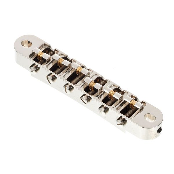

Two things that will take care of any potential problems should the post spacing be off compared to the bridge’s:
1. Consider these excenter bushings. They allow you to change the post spacing.
2. And/or consider the excellent ABM roller saddle bridge. Take special note of the adjustment it has for different post widths.
