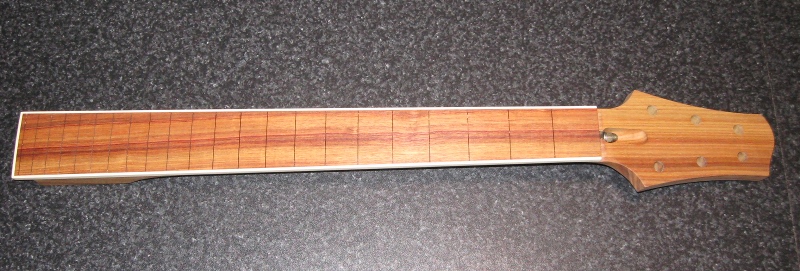

New neck day! Yay!
As the title says, this is a Canary/Canary 24.75" conversion neck w/ a Warmoth 2 headstock. I had them bind it with cream binding as well.
Kinda pretty, isn't it? Warmoth did an excellent job, as usual. Now I have something to do this weekend.
B-stock - frets missing?  :icon_jokercolor:
Congrats - Canary on canary is a sweet dish.  :icon_thumright:
WTF?!? I knew something looked funny! <grin>
Actually, I wanted to burnish the fretboard, and you can't do that with frets installed. Plus, fretwork with good (stainless or gold) frets is a serious adder when there's binding involved. So, I'll fret it. I've got the tools and skills, and a length of gold fretwire is only $11. Pretty time-consuming, but I haven't been diagnosed with anything terminal yet, so...

Yes, the 'board was a unique choice. I generally trust Warmoth, but on this one I had to have that piece.
I agree that gold hardware can become a problem fairly fast, but it's not usually a big issue for me. I have dry hands and I'm not an abusive player, plus my guitars are equipped and set up well enough that I don't have to retune them 30 times an hour. Plus, I have enough guitars to load share them.

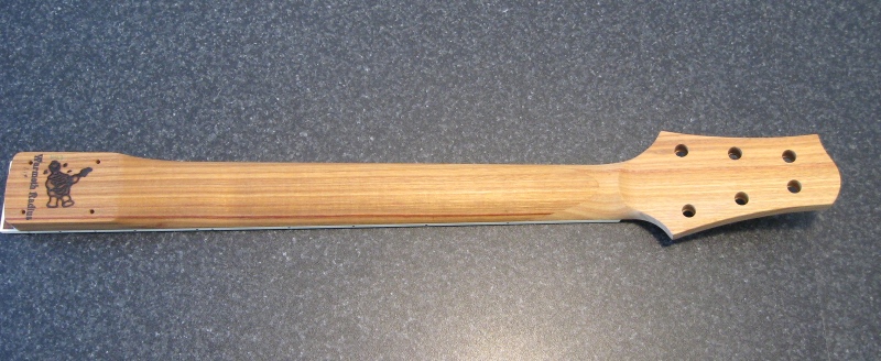

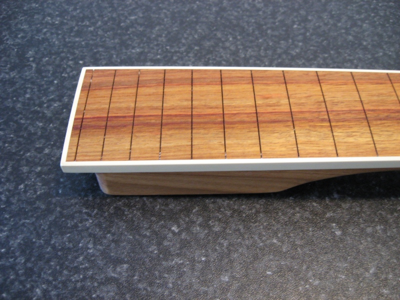

Here it is after polishing it up...
I broke the corners on the headstock with some 220 grit, then everything got treated to a progression of 400, 800, 1200, 1500 and 2000 grits. Thing is slicker'n snot.
Also, I weighed it and it's 1.1 pounds. Nice and light. Body's at 4.6, so we're currently at 5.7 pounds, less hardware. Should be a comfy instrument.

Wow. That's an impressive difference.  I might have to send you my VIP to work your magic on it, assuming you're willing and my finance department clears it.
I'm certainly willing, there's no problem there. A proper fret/neck setup is a Good Thing. It's that final bit that makes an instrument a joy to play.
